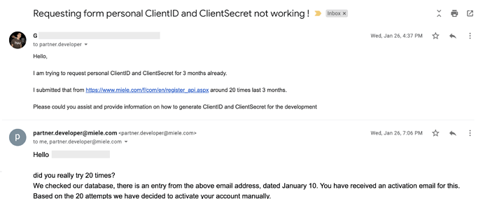

I can help here after 3 MONTHS emails with miele support…
make you aware you can make queries to your machine via api Miele 3rd party API - API documentation. To do so you will need access-
Get your personal developer credentials here: https://developer.miele.com. Submitted the form and was waiting and waiting… so just send them an email with what you need and hopefully, they will send you the credentials. (they also send me 3 times the wrong credentials… anyway). Use those credentials to authorize in HA yaml
