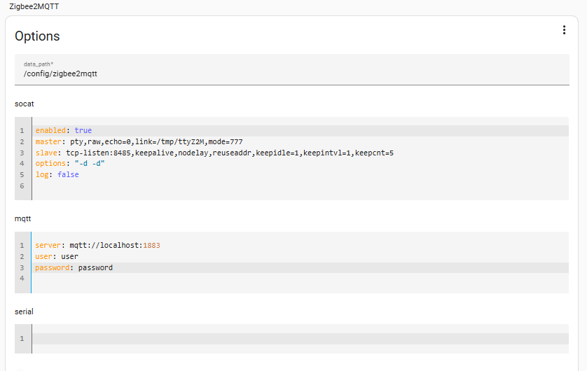

Please assist, I do not know what to put for serial:

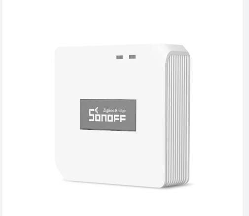

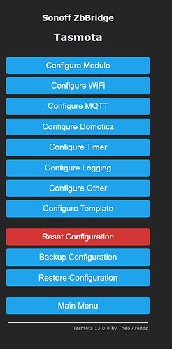

I am using this sonoff zigbee bridge:
and it has tasmota, it was previously working on ZHA but I got stuck with the migration at serial

Depending on what Zigbee firmware is flashed
serial:
  port: tcp://10.0.0.119:8888
  adapter: ezsp
or
serial:
  adapter: ember

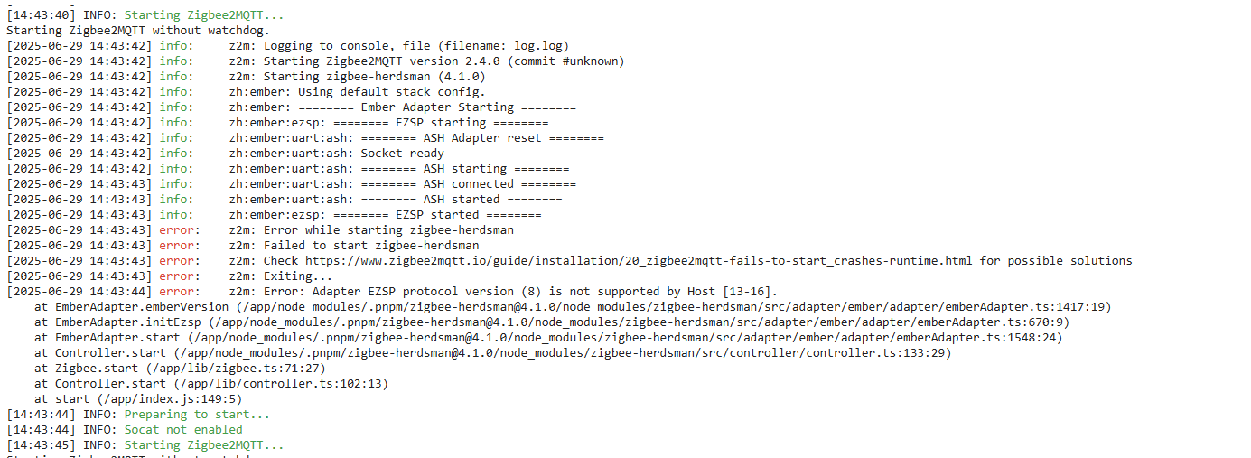

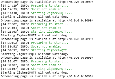

for both eszp and ember i get the following logfile, it does not seem to have started because I do not get the menu to join other devices:

stop Zigbee2MQTT, delete this line, restart Zigbee2MQTT
Thanks, there is some action albeit with errors:
Too old firmware. You need this
  adapter: ezsp
Finally :slight_smile:
