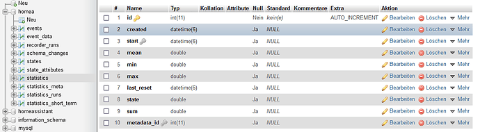

Hello There, I think i found one of your big peroblems. I had the Same Problem, my energymontior was going crazy. I used the python srcipt and transfered the DB with a second homeassisten in Virtualbox. when everythin was done i uploadet the DB with MySql Workbench. I was going crazy becaus the states table was correct and the data was plausible but the statistic had the same issiue. I setup a new Database without any table and let them creat by home assistant to understand what the difference could be. i recognized that the structure was worng. The uploadet Database used float as datatype and the original (createt by homeassistant) double.(for example) I compared all tablestructures and correctet them now the new incomming data looks much better :wink:
I am sorry for my bad english :wink:
AMAZING!!!

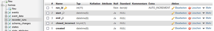

I checked the the database which was created by script and you can see that the script was the problem. :smiley:
don´t use this structur :wink:
Is „the script“ referring to this migration how-to and if so, will it get updated?
Yes I used this migration how-to. you can use ist also, but befor you change the recorder-url from your “live-system” you´ll have to controll the data-types and correct them. I made some screenshots for you, with my “correct” structures.
