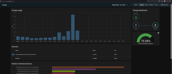

Today I also moved my Home assistant 2022.9.4 to MariaDB - Migration went (besides a couple of columns had a wrong datatype or missing index) well, but I also have the Energy Dashboard problem. My Graph looks quite good, and the measurements are also correct (either on UI and in DB) but as mentioned above my costs are ridiculous… 1 kWh is 86.63€ (even for me, living in Germany is the price a bit high ^^)
But it seems that the prices don’t have anything in common with the consumption… Like in the picture now (a couple of hours later) - I now have consumed 3.96 kWh, but the price is only “a bit higher” (8€ for the next 2 kWh)…
Did anyone find a solution for this? - I’ve tried creating a new sensor, but there is also the same problem. Even a new Migration did not solve this :confused:.
I even noticed that the “Non-Fossil energy consumed” Chart may be a bit too high – normally I’he more like 50 - 60% but never before 76% Percent…
Hope anyone already solved this issue :slight_smile:

Same problem here. Please keep us posted on a solution for this home assistant specific energy crisis :wink:
Yea, energy cost calculations got messed up for me after migration to MariaDB. It now just accumulates all the sums, instead of all the differences. It’s possible to recalculate the history in the database, but it still continues to calculate wrongly. I posted a more detailed reply here.
