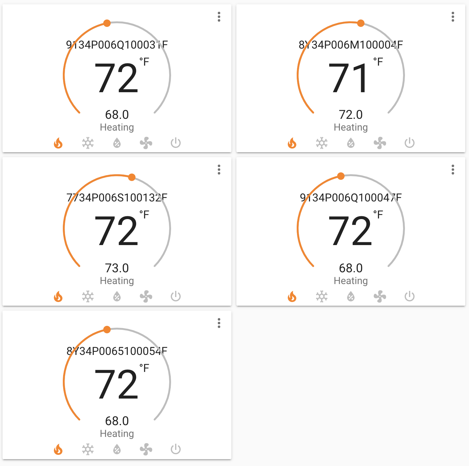

Hi Doug, I just got around to testing the zones branches out. It picked up all five of my unites, including the 4 in a zone, but the naming of the units seems to be the serial number rather than the “label” element from the configuration file. Here’s what I’m seeing:
My apologies, I didn’t push all the required changes to the https://github.com/dlarrick/hass-kumo/tree/zones repo. Please pull that one again.
That looks better!
