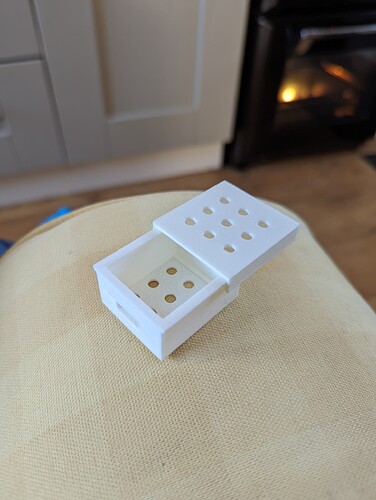

Holes are vital. It’s how the WiFi and radar particles can get out of the box :wink:
I nearly went the same way as you. I’ve modified the box for mine now and it works nicely.
I need to make one more tweak and then I’ll be completely happy.
You mean design the HA logo into the top; am i right!?
Hold my beer…
