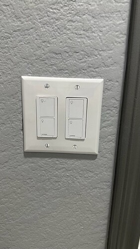

This has been a fascinating journey and I am quite happy with what I was able to do. Thank you for your research and here is my implementation of the LD2410 BLE sensor.
Project:
  • WeMo D1 ESP development board for Bluetooth Proxy
  • LD2410 BLE from AliExpress
  • 110/210v to 5v converter from AliExpress
Problem:
  • PIR is not good enough for bathroom usage. Many times people are not moving enough to make the PIR detect motion.
  • Wanted to determine if #1 or #2 was potentially being conducted and in turn if the later turn on the exhaust fan if not already on
  • Once occupancy by the MMW was clear; run fan for an additional 5 minutes while turning off the lights immediately
Worked out quite well in my bathrooms. Pictures showing the device and placement. Works flawlessly. :slight_smile:
