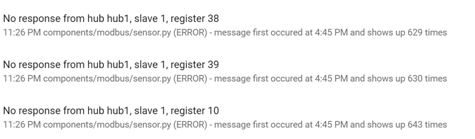

I reduced sensor.yaml to the following:
## MODBUS ##
- platform: modbus
registers:
- name: Firmware Version
hub: hub1
slave: 1
register: 10
- name: Holiday
hub: hub1
slave: 1
register: 38
- name: DHW On Prohibit
hub: hub1
slave: 1
register: 39
Minutes is what I expect with HA modbus…what about the same sensors in node-red?
How is the log looking with just those sensors now?
If the log is looking better rework all your HA sensors to something like the above and observe for 24 hours I think…noting what happens to values when you adjust settings from the HMI.

Transaction failed. (read failed: device reports readiness to read but returned no data (device disconnected or multiple access on port?))
That tells me your device is being read simultaneously by HA and Node-Red
That is a problem. You probably need to think carefully about how you move forward.
As a for instance…If I am updating my PLC program. I first MUST stop HA.
I find it is not possible to have two “Master” devices running at the same time without errors.
I suspected that node red could play it’s negative role …

Did you eliminate one?
Sensors working better?
I deleted node red flows and restarted HA.
Errors are still same. Weird.
And how are the sensors going? Accurate values?
Maybe post some more from the logs?
Can’t use HMI so sensor values are unknown. I expect them to be correct.
some more log:
