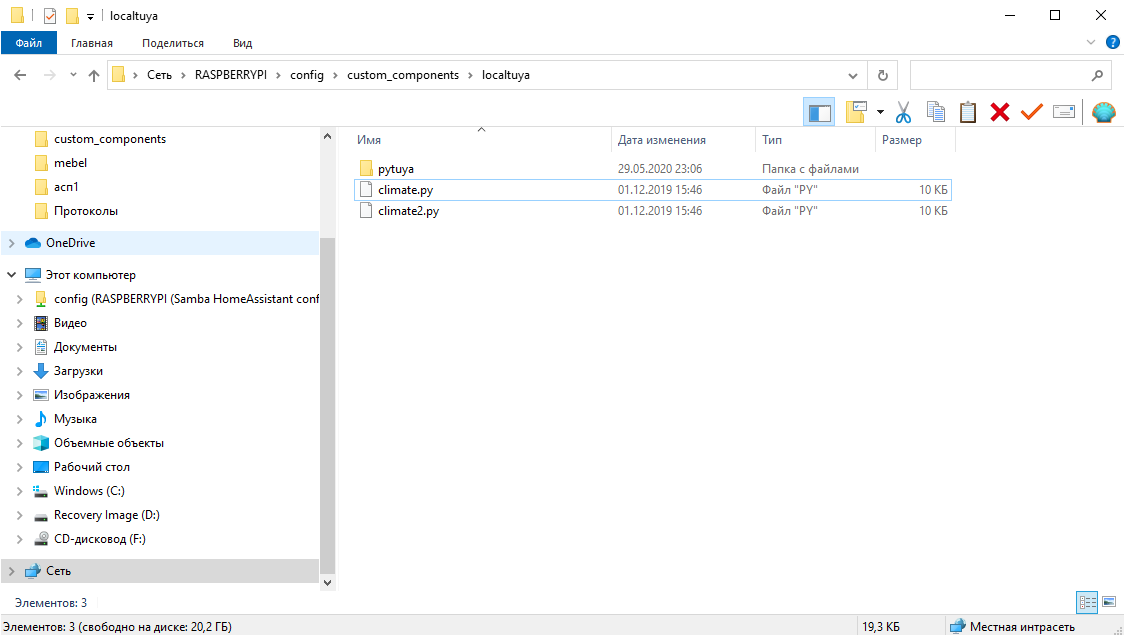

Also I’ve downloaded the localtuya folder from GitHub that was attached in the original blog post
mich41v4294 try to change in:
protocol_version: 3.1

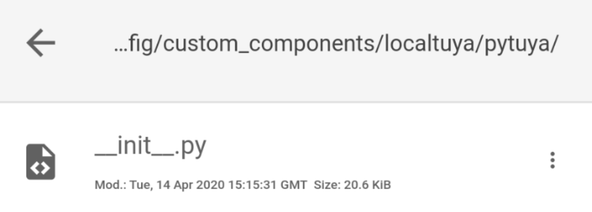

You download all files from github? All files required.
Full file list:
I’ve got this
Didn’t help
Try delete all files in “_pycache” folder.
