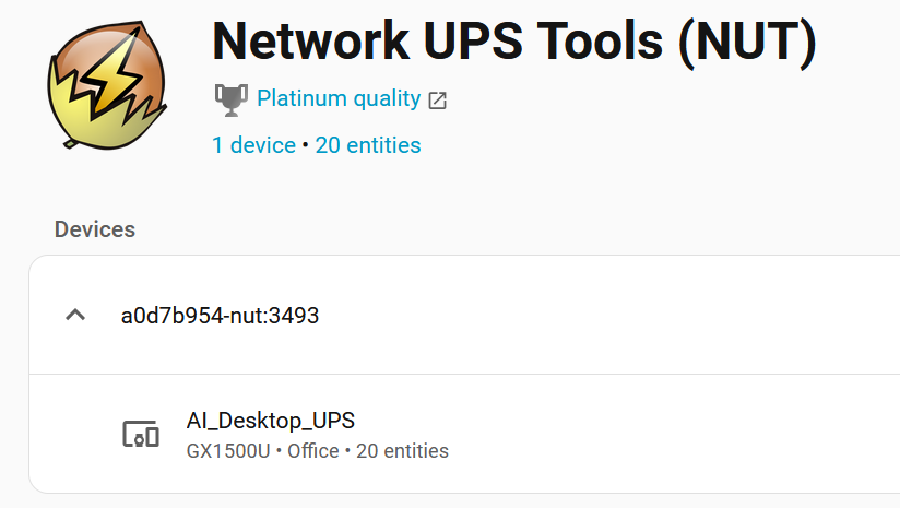

I found once I had the Cyberpower software installed and set up an the SNMP gateway, it was extremely simple to just add it to NUT, and not worry about manually creating sensors or cards in Home Assistant.

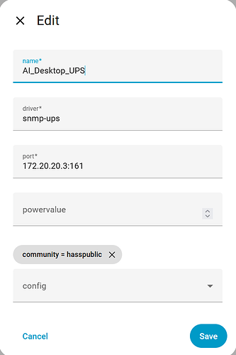

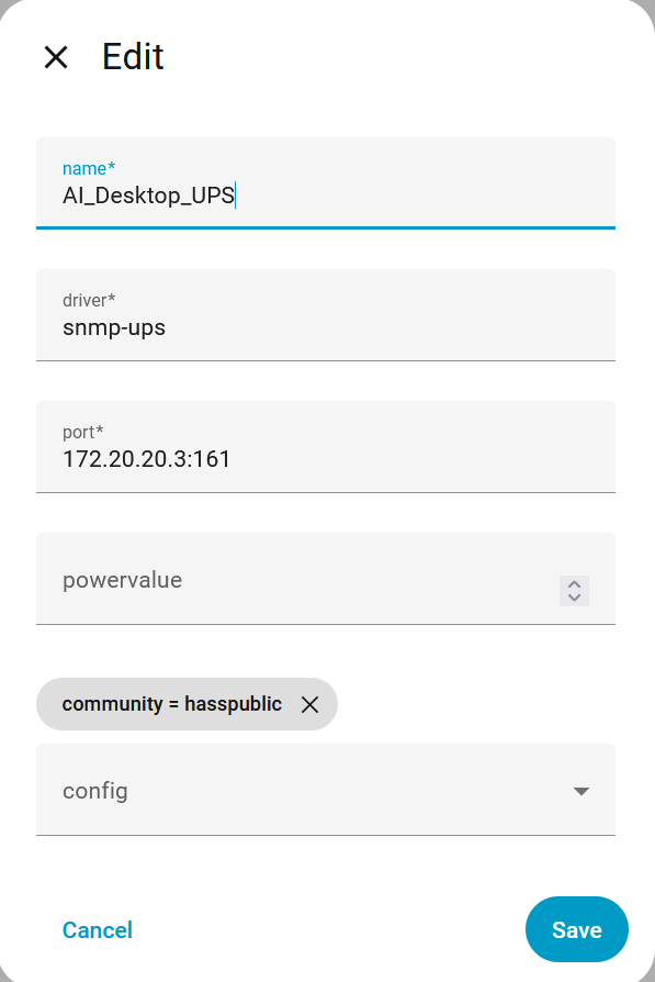

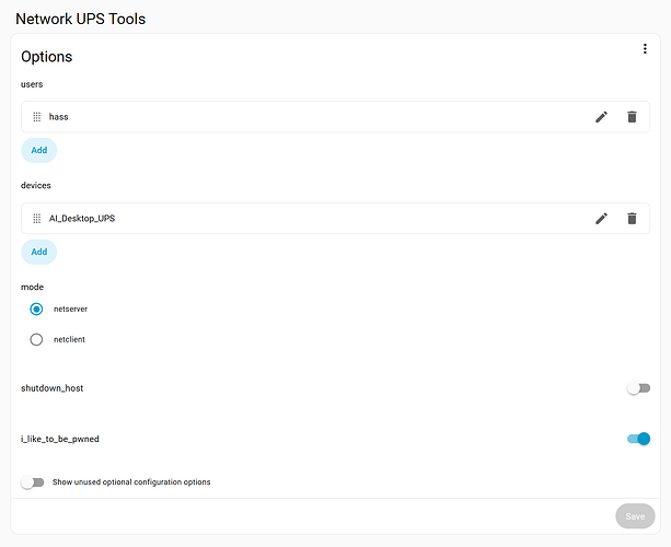

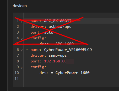

fyi, NUT add-on config for the Cyberpower SNMP device:
  - name: CyberPower_VP1600ELCD
    driver: snmp-ups
    port: 192.168.0.x
    config:
      - desc = CyberPower 1600

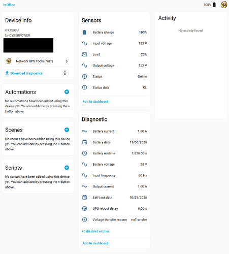

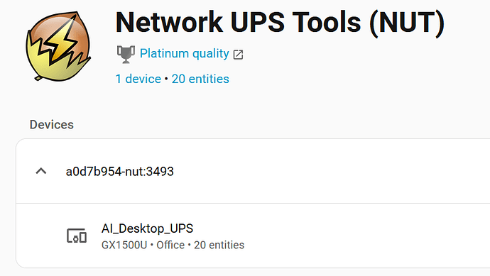

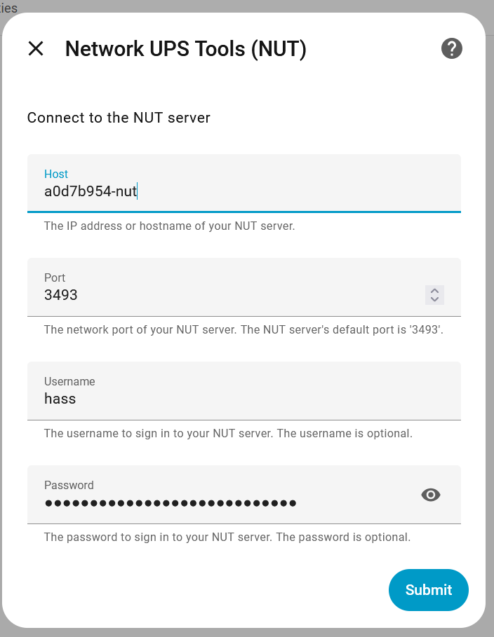

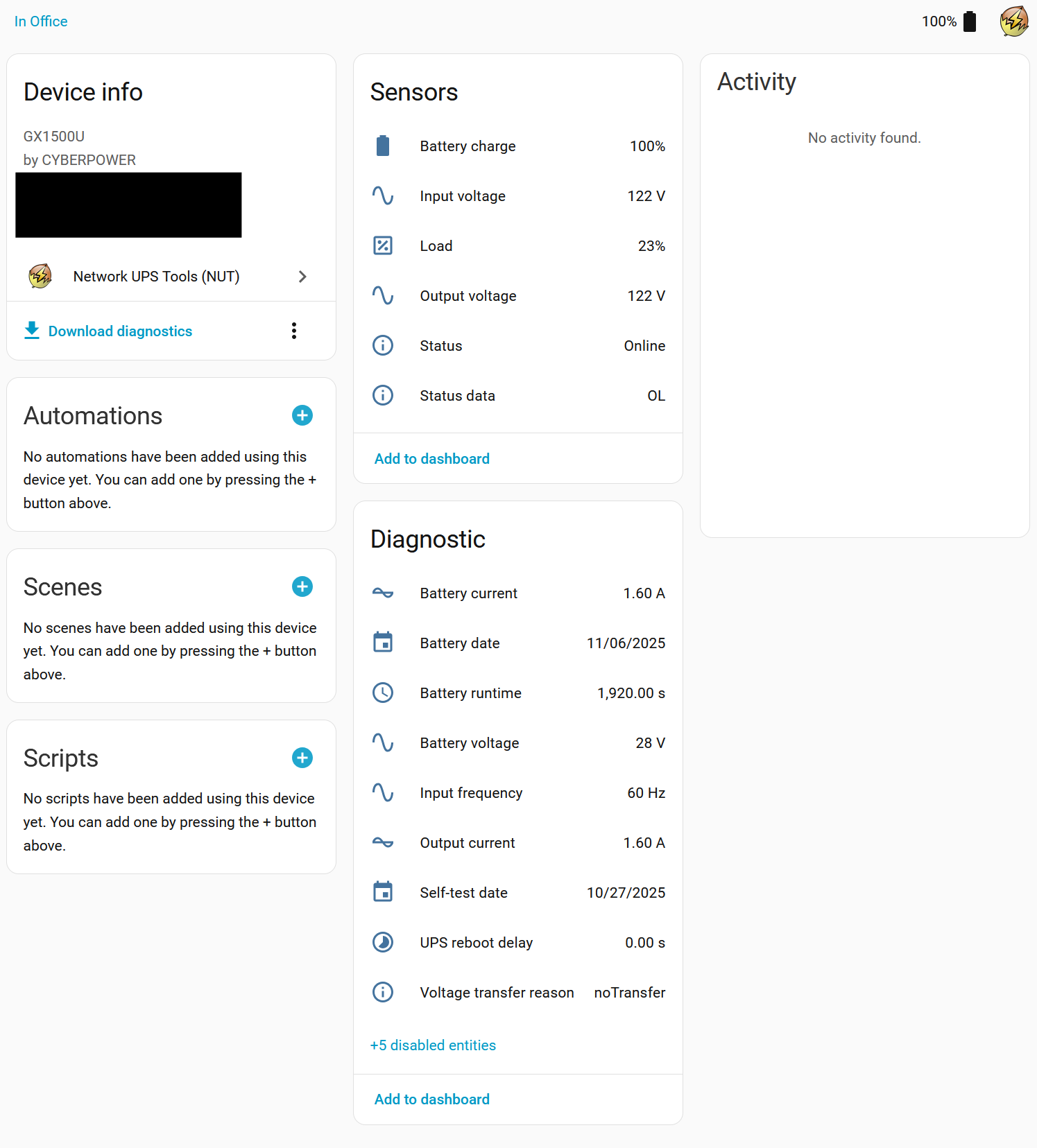

Then just add it as a new device in the NUT Integration:
Good Job @Simon_Bunn

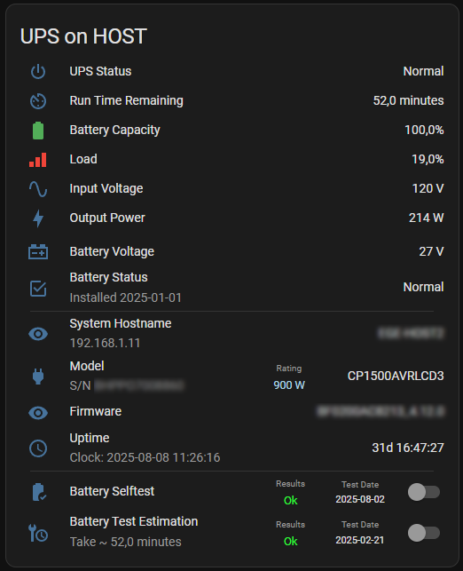

# CyberPower UPS
# UPS on 192.168.5.10 - MyServer
# version 2026-08-26 08:58:18.281
# --> Round some values, and remove 'UPS01 Output Power' which seems to be buggy.
#     Recomendantion: is to use a 'Helper' calculation where
#           power = output_current * output_voltage
# version 2025-08-22 00:24:11.616
# --> Change some int to int(0) and float to float(0) for default value at startup
# Inpired by:
#   https://community.home-assistant.io/t/cyberpower-ups-powerpanel-cloud/509968/7
# Confirmed working for model:
#    CP1500AVRLCD3 - PowerPanel Business v4.12.2 on Windows 11 (10.0.26100 64-bit)
#    CP1350AVRLCDa - PowerPanel Business v4.12.0 on Ubuntu 22.04.1 (Linux 6.8.0-136-generic 64-bit)
# Download location: https://www.cyberpower.com/global/en/download
#    Windows: CyberPower_PPB_Windows_v4.12.2        - PowerPanel Business Local/Remote for Windows
#    Linux:   CyberPower_PPB_Linux+64bit_v4.12.0.sh - PowerPanel Business Local/Remote for Linux 64bit
# unique_id: generated on: Version 1 of https://generateuuid.online/

Here is my “graphical” modifications:
title: UPS on Host
type: entities
entities:
  - type: divider
    style:
      height: 0px
      margin-top: "-20px;"
  - entity: sensor.ups01_advanced_status
    icon: mdi:power
  - type: divider
    style:
      height: 0px
      margin-top: "-15px;"
  - entity: sensor.ups01_run_time_remaining
    name: Run Time Remaining
    icon: mdi:av-timer
  - type: divider
    style:
      height: 0px
  - entity: sensor.ups01_battery_capacity
  - type: divider
    style:
      height: 0px
  - entity: sensor.ups01_load
    icon: mdi:signal-cellular-3
  - type: divider
    style:
      height: 0px
  - entity: sensor.ups01_input_voltage
  - type: divider
    style:
      height: 0px
  - entity: sensor.ups01_output_power
    icon: mdi:lightning-bolt
  - type: divider
    style:
      height: 0px
      margin-top: "-10px;"
  - entity: sensor.ups01_battery_voltage
    icon: mdi:car-battery
  - type: divider
    style:
      height: 0px
  - entity: sensor.ups01_battery_status
    icon: mdi:checkbox-marked-outline
    type: custom:secondaryinfo-entity-row
    secondary_info: Installed [[ sensor.ups01_battery_installed_date ]]
  - type: divider
    style:
      background-color: none
      height: 1px
      margin-top: "-5px;"
      width: 95%
      margin-left: auto
      margin-right: auto
  - type: divider
    style:
      height: 0px
      margin-top: "-5px;"
      width: 95%
      margin-left: auto
      margin-right: auto
  - entity: sensor.ups01_hostname
    secondary_info: "[[ sensor.ups01_ip_address ]]"
  - type: divider
    style:
      height: 0px
      margin-top: "-5px;"
  - entity: sensor.ups01_model
    type: custom:multiple-entity-row
    icon: mdi:power-plug
    secondary_info:
      entity: sensor.ups01_serial_number
      secondary_info: sensor.ups01_serial_number
    entities:
      - entity: sensor.ups01_power_rating
        styles:
          width: 100px
          text-align: center
          color: lightblue
          font-size: 12.5px
  - type: divider
    style:
      height: 0px
  - entity: sensor.ups01_firmware
  - type: divider
    style:
      height: 0px
  - entity: sensor.ups01_uptime
    icon: mdi:clock-outline
    secondary_info: "Clock: [[ sensor.ups01_date_n_time ]]"
  - type: divider
    style:
      height: 1px
      margin-top: "-5px;"
      width: 95%
      margin-left: auto
      margin-right: auto
  - type: divider
    style:
      height: 0px
      margin-top: "-5px;"
      width: 95%
      margin-left: auto
      margin-right: auto
  - entity: switch.ups01_test_battery
    icon: mdi:battery-check
    toggle: true
    secondary_info: null
    entities:
      - entity: sensor.ups01_selftest_result
        styles:
          width: 60px
          text-align: center
          color: lime
          font-size: 12.5px
      - entity: sensor.ups01_selftest_date
        styles:
          width: 65px
          text-align: center
          font-size: 11px
  - type: divider
    style:
      height: 0px
      margin-top: "-5px;"
  - entity: switch.ups01_calibrate_battery
    name: Battery Test Estimation
    icon: mdi:wrench-clock
    toggle: true
    secondary_info:
      secondary_info: sensor.ups01_run_time_remaining
    entities:
      - entity: sensor.ups01_advance_test_estimation_results
        styles:
          width: 60px
          text-align: center
          color: lime
          font-size: 12.5px
      - entity: sensor.ups01_advance_test_estimation_date_temp
        styles:
          width: 65px
          text-align: center
          font-size: 11px
show_header_toggle: false
state_color: true

In Nut you can have it output SNMP by listing all the OID’s it should respond to. I do that so I can monitor my NUT devices with Zabbix. But that is sort of the inverse of what you are looking for I think.

On the Windows box that is connected to the CyberPower GX1500U UPS via USB I am running POwerPanel Business 4.12.0. I have PowerPanel Business configured to allow SNMP polling.
I am running Home Assistant on a different machine with the Network UPS Tools (NUT) add-on. I have the Add-On itself configured as below:
And the individual desktop configured like this:
Then, back within Home Assistant Devices I added the NUT integration and then added the NUT Addon as a device using the “user” I created within the addon:
This dropped the UPS into Home assistant as a device:
Hope this helps!

I just set it up running in docker desktop on my windows box where powerpanel is running (and the UPS connected) so it’s still using snmp. It works well though is pretty slow to update the values in HA but that may just be some tweaking I need to do.
I am using haos but prefer standalone dockers and the Nut addon (via snmp) wasn’t staying connected for me.
Do also note that you can pull the data in directly with snmp templates on the config if you don’t want to use any NUT at all. I had it that way for a couple years and no complaints besides it taking a long time to start the snmp integration on restart of HA.

Great suggestion! This was easy to setup and seems to work well (shows more information than my prior DSM method)!
