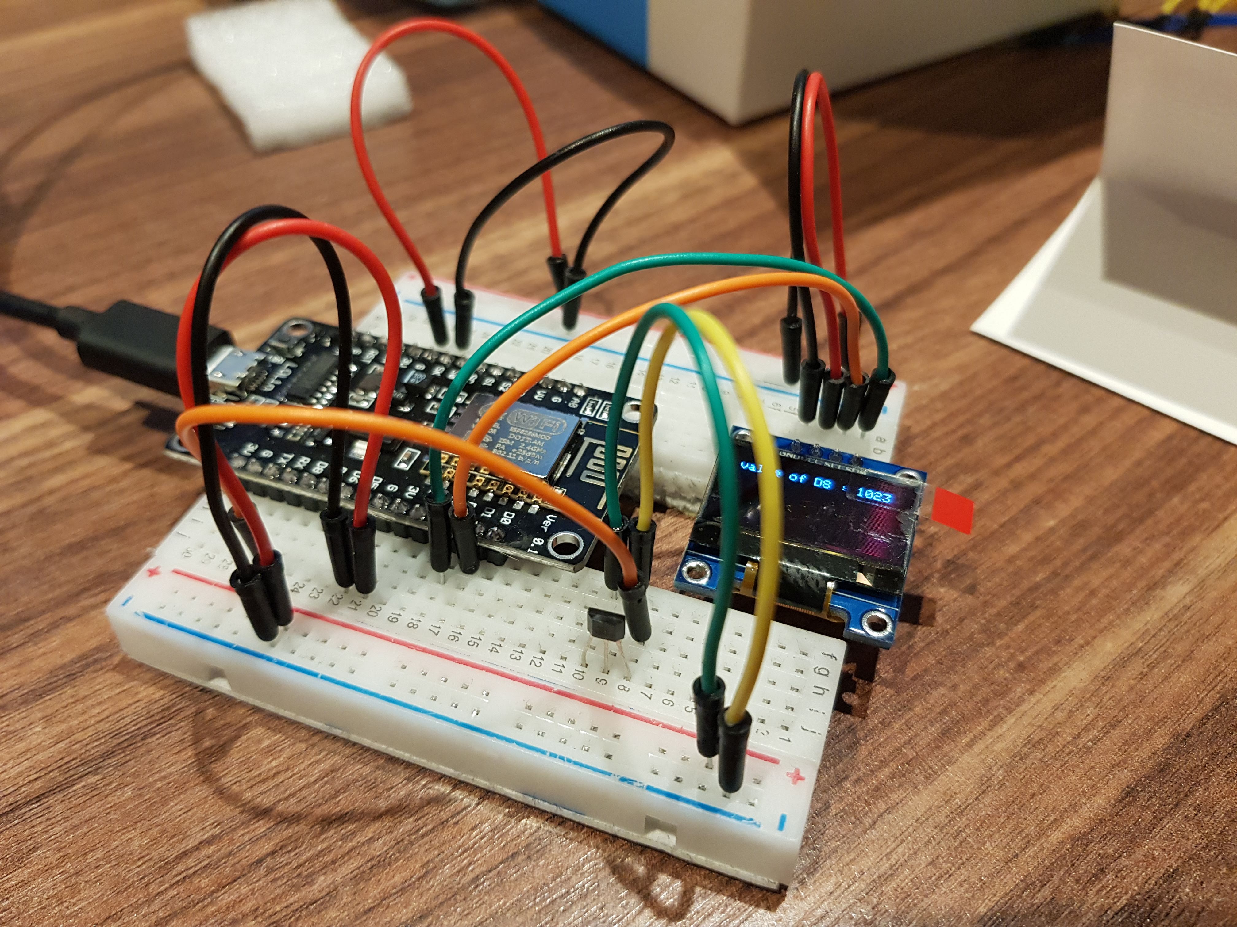

After a bit of scribbling on the back of some unused schoolwork (hah!) we came up with a simple design, built around an ESP8266, SSD1306 display, A3144E hall effect sensor and some very powerful magnets:
First prototype, using a NodeMCU dev board to test the sensitivity of the hall-effect sensor (the 3-pin package at the front of the breadboard) - we had to swap for a different one to get a more reliable pickup:

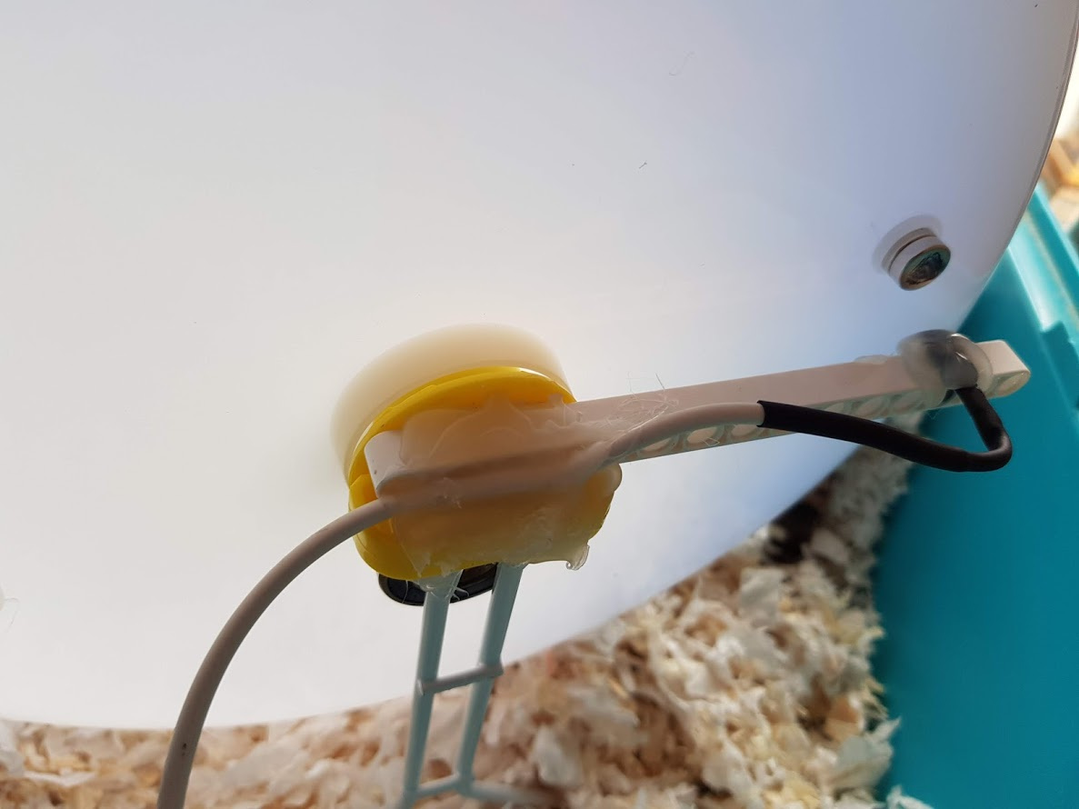

We used a “bespoke sensor mount” (i.e. we raided the kids’ lego box and made extensive use of the hot glue gun :slight_smile:) to mount the hall-effect sensor and magnets to the hamster wheel itself:

I’d have to spend a bit of time sorting out the software first as it’s all a big spidery mess at the moment, but the electronics are trivial - the actual A3144E sensor just needs 3 connections - 3.3v, GND and data, which has a 10k pullup resistor to the 3.3v supply (you can see this soldered to the PCB in one of the pics). This then drives an interrupt so every time the magnet passes the sensor, a function is fired in the code (which just increments a counter). Everything else is just a bit of basic maths, and scaffolding to get the data back to HassIO for MQTT.
