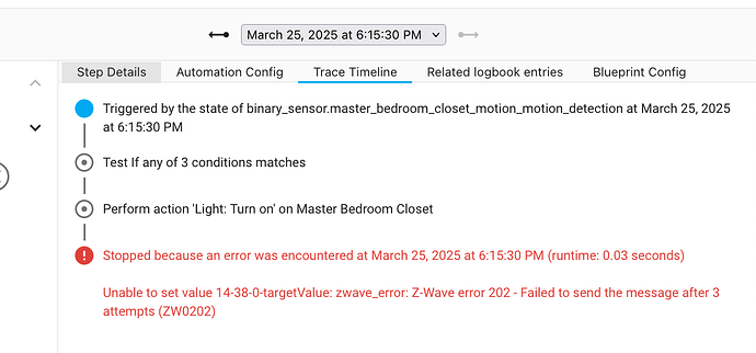

This seems like a very strange error to me. The code at this point is really simple — it just calls the service to turn on the light.
Could I ask you to describe the behavior more clearly?
Does the light turn on and then you receive the error, or does the light not turn on at all?
If the light doesn’t turn on, have you tried using a different light (not based on Z-Wave)?
Let me know what happens and I’ll try to help you to fix.
