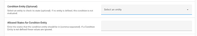

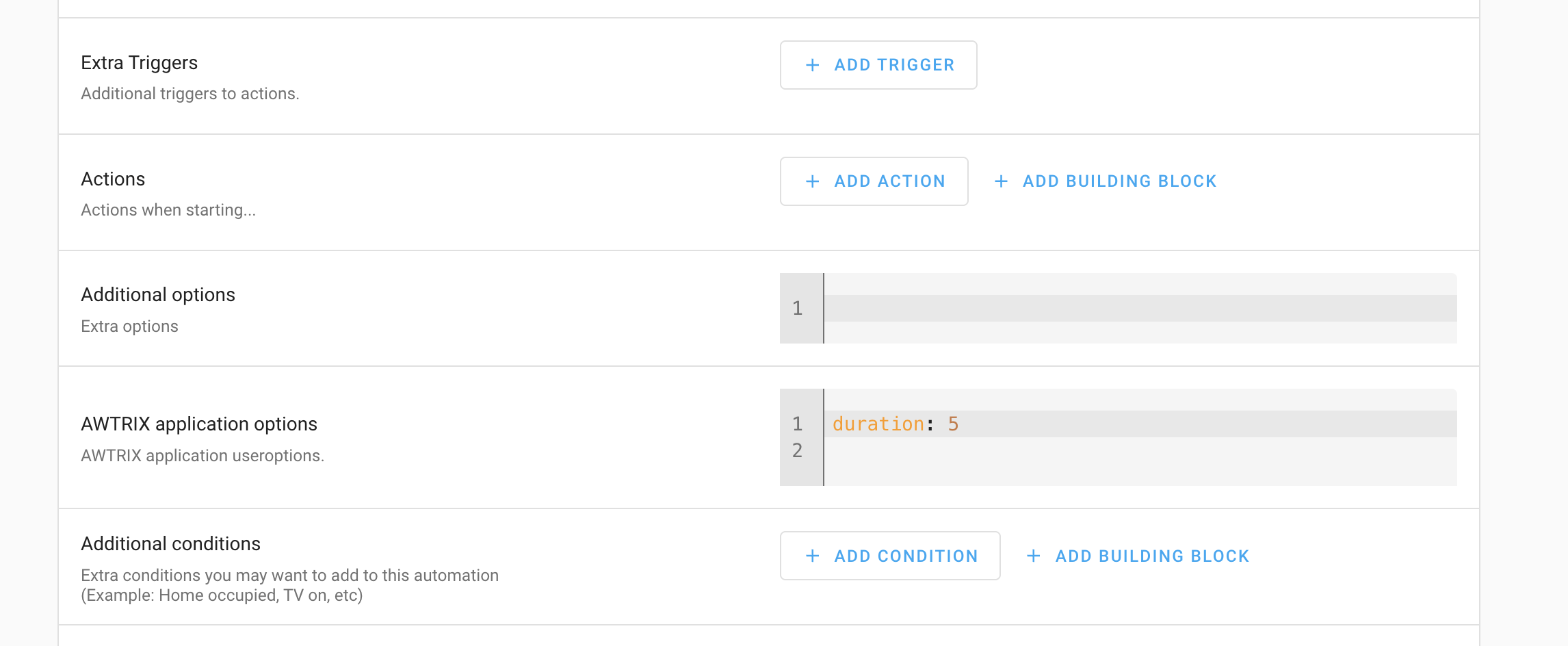

yeah, it doesn’t. I am working with someone who is trying to help me get it fixed - thank you @JorgWolski

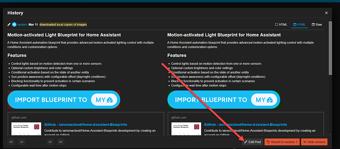

Pencil icon then
I don’t have that option @petro ?

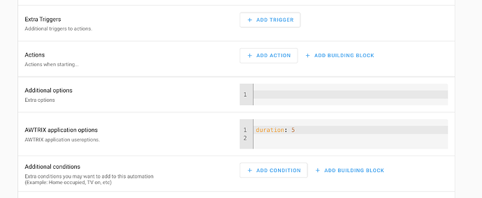

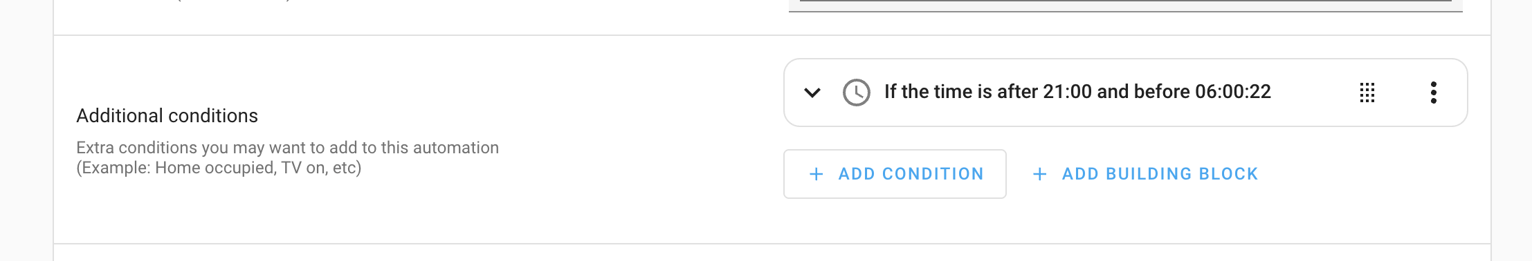

mb easy to replace
with
something like
    additional_conditions:
      name: Additional conditions
      description: |
        Extra conditions you may want to add to this automation
        (Example: Home occupied, TV on, etc)
      default: []
      selector:
        condition:
btw, this this case you can simply remove also sun (time) constrant.

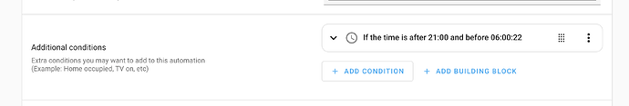

here is the simplest variant of your blueprint without sun and other conditions but user can add any own
Excellent, this now seems to work, thank you. Apologies for the delay in replying.
