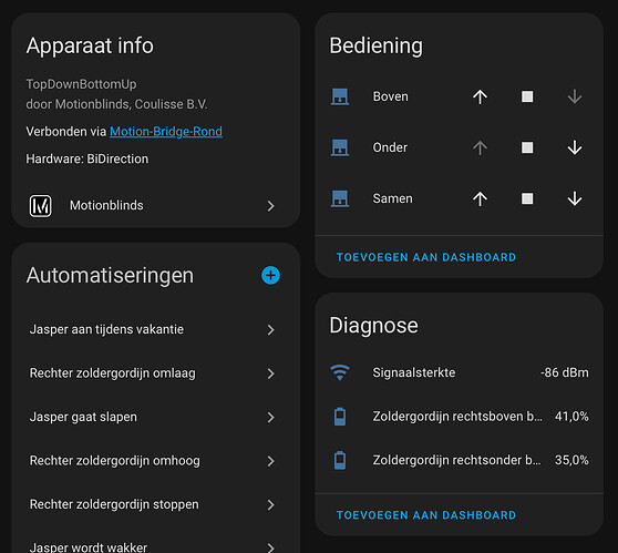

I recently integrated the MotionBlinds CM-55 bridge into HA, which controls two honeycomb blinds with four motors (top-down, bottom-up). However, it only detects one battery level, whereas I expected it to show two.
For TDBU I think you should see three cover entities and 2 batteries. I’m not using Matter or the CM-55 though, so maybe they are not fully supported yet, or not in the same way. Do you have two devices, or more? Maybe they are split because Matter does not support multiple covers in the same device?
You’re absolutely right, I added them as Honeycomb blinds, not as TopDownBottomUp blinds. I had to remove and reinstall the Motionblinds integration to remove the incorrect Honeycomb devices and add the correct TopDownBottomUp blinds.
