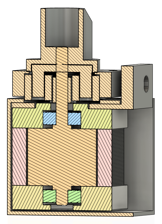

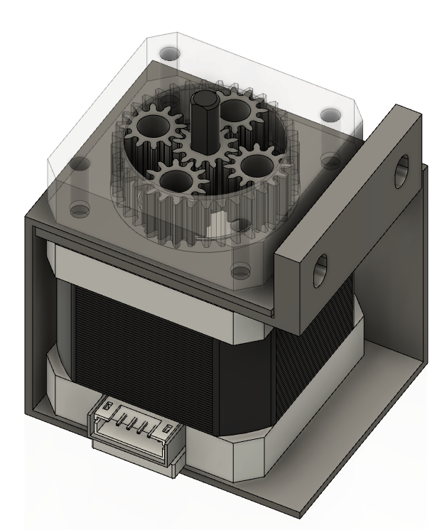

The mounting/gearbox looks like this:
So for mounting:
Screw the bracket with the oval holes to the ceiling.
Insert stepper motor.
Slide casing over it (just for looks, to hide the stepper).
Put on the gearbox, screw into stepper at the 4 corners of the stepper.
