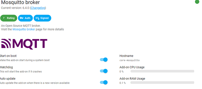

Thank you ShadowFist - looking better
Mosquitto broker I think is now going - green dot in top right of screen
However do these log files look OK?

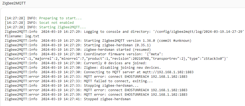

I have restarted home assistant and am now getting the following message when I try to restart MQTT
Red dot in the top right of MQTT screen and these log files
Thanks again to all for assistance - Fergus
Check your Z2MQTT settings. Something tells me you only added a single / after mqtt:// , but I can’t confirm because you blacked it out. See this post above.
Also, make sure you restart the Z2MQTT addon after any changes, and double check that it’s pointing to your MQTT broker correctly (should be your HA IP address:1883, or 192.168.1.102:1883)
Thank you Shadow Fist - I have done a HA restart
Mosquitto broker seems running - green dot top right
These are the log files on Mosquitto
The New Connection and Client lines keep repeating for say 50 times then at the bottom we have
However does the green dot indicate Mosquito is running fine.
Now on to MQTT itself - this is not running. I checked for the two forward slashes as you mentioned and this looks OK. Here is the config without any redacting.
and here is the log file
thanks again for commenting on this installation - Fergus
try:
server: mqtt://core-mosquitto:8123
Dear Francis
Yipee - I think you have done it. So many thanks.
Both Mosquitto broker and Zigbee2MQTT both seem to be running now fine - thanks Green dot in top right.
