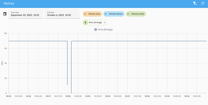

ok and what does the graph look like?

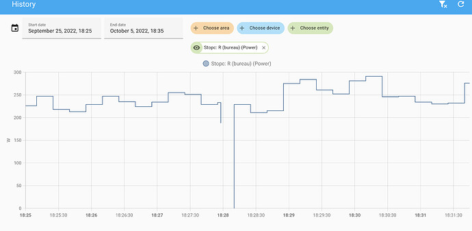

Sorry, this is the correct one. Your automation was for airco energy. I took the wrong one. But you can see that the issue is here too.
I guess they don’t have the order of operations correct with availability and value_template for the MQTT platform.
remove the availability stuff then and use this as a value_template
value_template: >
{% set avail = value_json.channelPowers | map(attribute='power') | list | sum != 0 %}
{% set result = (value_json.channelPowers[0].power + value_json.channelPowers[1].power + value_json.channelPowers[2].power) | round(0) %}
{{ result if avail else none }}
This seems to work. Now when I post the faulty json the entity state changes to “None” and I only see a gap.
I adjusted all 120 entities with the new value template and tested multiple times. It seems to work well now.
So the problem is a bug in HA MQTT integration?
Yep
