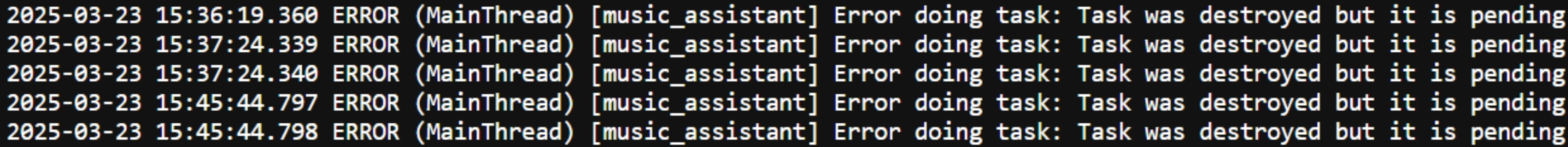

Hello :slightly_smiling_face:. I could use some help troubleshooting Music Assistant if anyone would like to help please.
I have enabled a Music Provider (Spotify, it’s marked as authenticated too) and a number of Player providers (Multiple Google nest hubs and a Denon AVR entity via Media Players). When I choose a nest hub for instance, it powers on and I can even control the volume through the music assistant UI. However when I hit play, nothing happens. I get no sound and no progression on the song timeline either.
At one point there was an error that specifically stated “failed to play” in it, but I have not been able to reproduce this error to take a screenshot. Instead, here’s a screenshot showing a recent log file saying “task was destroyed but it is pending”. I did look this error up and there was not much in the way of fixing it in relation to Music Assistant.
I appreciate any feedback! I really want use Music Assistant, it looks badass! :heart_eyes:

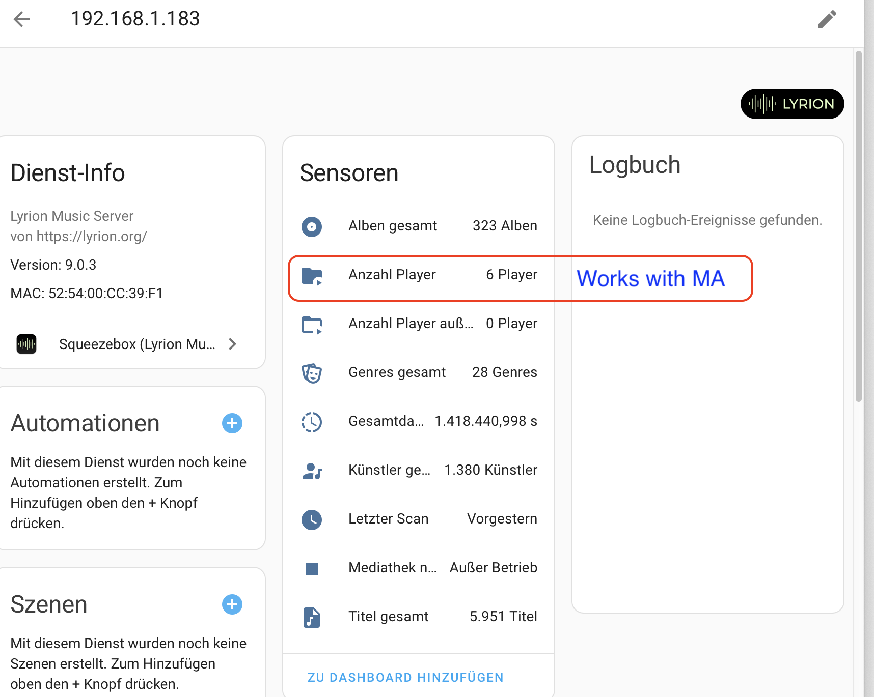

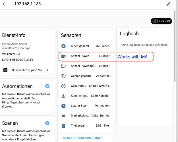

@OzGav I use the integration Squeezebox (Lyrion Music Server) in HA and can access the players in the LMS in MA without any problems.
My question is whether you can also access the stored media in the LMS.
No and you should review the MA documentation
  • Running LMS on the same server as MA with the MA Squeezelite provider enabled can have undesired effects
  • Make sure that you do not have the “slimproto” (Squeezebox players) integration running in Home Assistant

My LMS runs on a separate virtual machine.
And with this setup I still have no problems. :man_shrugging:t3:
