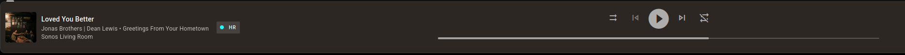

Further investigation on this I discovered that the playlist is STILL there, only not shown when the source is set to TV.
Once I clicked the pause button:
The playlist comes back:
Unfortunately I cannot do this in an automation as the media_player pause/play actions do not do anything, only manually clicking on it will work.
Does someone know how to clear the TV input_source in an automation?
