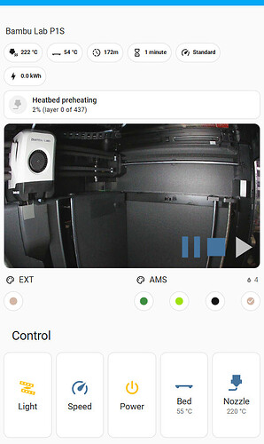

My Bambu Lab X1C Dashboard & Automations

here is my A1 dashboard, i use tapo as camera. I dont use external spool.
Requirements:
Bambu Lab
Mushroom
card-mod
hui-element
code:

This looks nice - how did you add the image of the model being printed?
The entity is called:
image.a1_cover_image
This is such a popular printer, there should be an official integration to hass. How do you request integrations?
@benji Thank you for the code :+1: I adapted it to my liking, it is awesome.
Hi, can you share code of your beautiful configuration
Thanks
Disclaimer: The code provided here is for an A1 printer, sensor names etc all reflect that.
The code here uses some custom mods, such as custom:mushroom-chips-card, custom:mod-card, custom:button-card, custom:bar-card you have to have these before hand. The code is working fine. Make sure the code you put in your yaml is the same as the code provided here.
Here is my code:

My take on a dashboard for a P1S. The goal was to use as few dependencies as possible and avoid card_mod. Only dependency is Mushroom cards.
