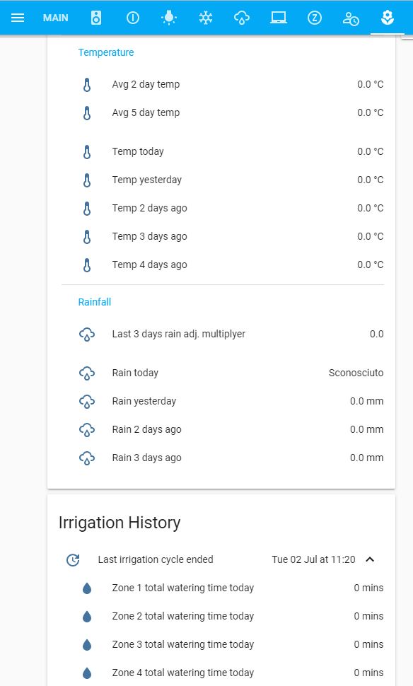

But I see that all temperature and rainfall history are 0.
Darksky is configured and running. Should I enable something specific to have history working?

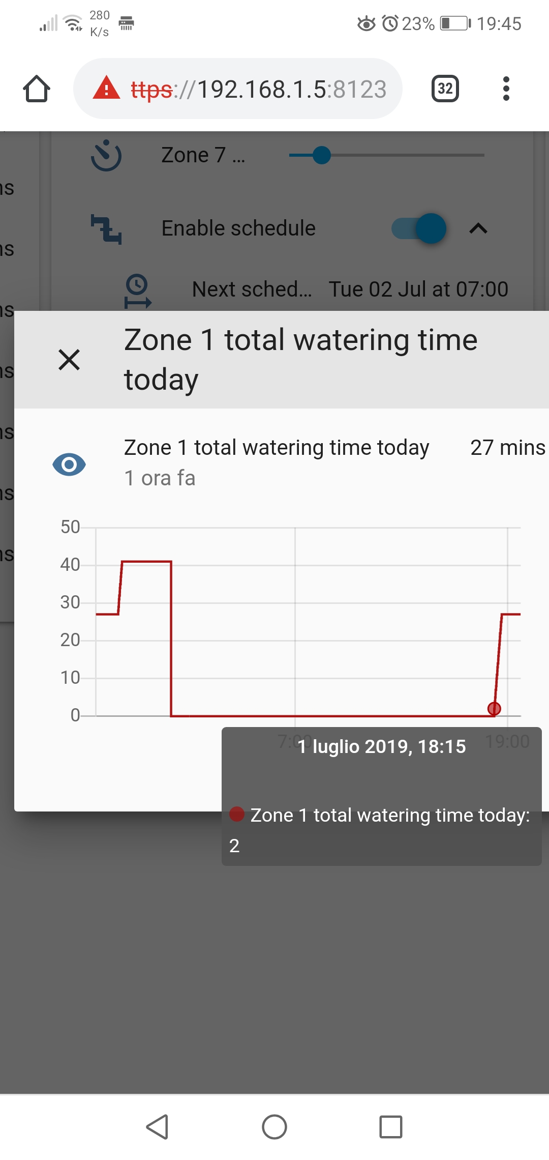

Today i got a strange problem. I opened my dashboard and i’ve seen that scheduler (both for morning and afternoon) was off. They was ON until yesterday i’m sure.
I reenabled one (morning) at 06:00 daily (so next run is 2 july 06:00 am) BUT the system started today 1 july at about 18:15…!!! I don’t know the problem… Any suggest? See attachment

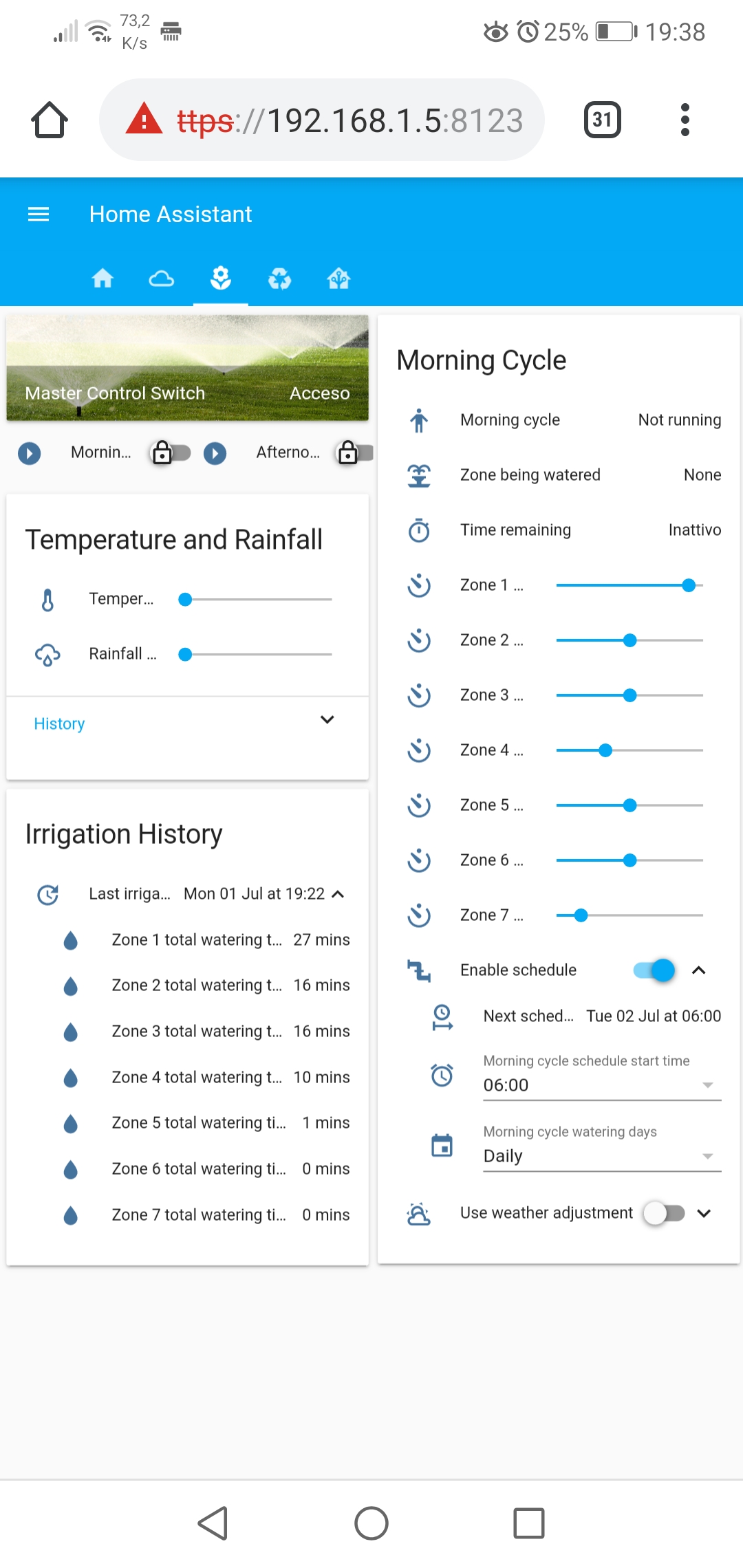

Ok, sonoff 4ch R2 arrived, I just gave to its switches the same valve names that you used, and it work.
Manual and scheduled moning&afternoon cycles are working and relais are triggered at specified times and using specified duration.
I added earlier times for morning and later times for afternoon.
Perfect. It can already do what my current irrigation system can do, so i think that soon I will replace it.
I’m not sure if I will use weather adjustement or not, I’d like to observe what it does for a few day before chosing.
I have a problem that is preventing me to check this data… histories are not present, they all show zero.
On more, and probably most important, thing is that on reboot schedules get turned off.
Zone duration and schedule settings are still there, but simply schedules are turned off.
