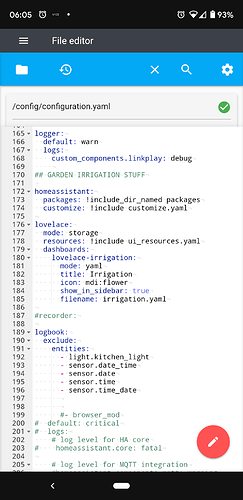

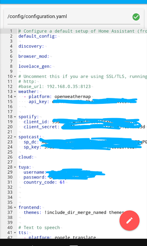

Thanks, but I haven’t split my config, so the date and time sensor is in my main config.

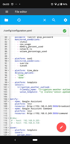

Here is the relative sections in my configuration.yaml
Just one observation under your logbook config, i see that you have excluded date and time sensors ? wouldn’t these be needed, under my logbook config this is left empty not excluding anything, i think that they may be needed to be read by the logbook for it to have any readings, i may be wrong but worth a try deleting those from the logbook, apart from that all looks fine.
That’s just excluding them from the logbook, otherwise it clogs it up with time updates.
I’ve tried with and without anyway.

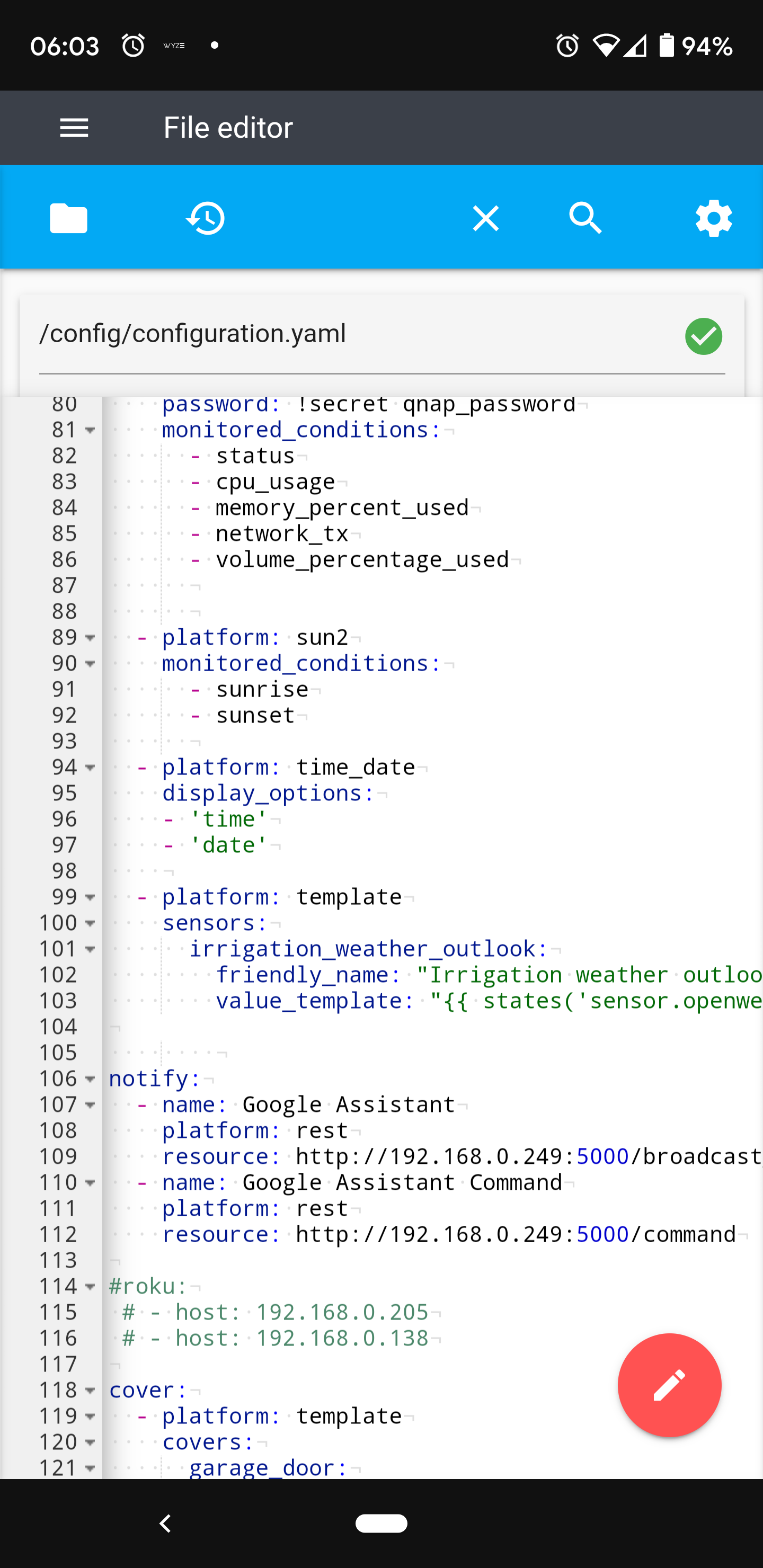

Experiencing somewhat odd behavior. I see you mention date and time sensors. I have the correct timezone selected and also have my date and time sensor set
sensor:
- platform: time_date
display_options:
- 'time'
- 'date'
Something happens during the night up until the following day. It literally only happens after the schedule is set for a day after 24 hours or a day has passed.

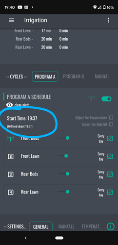

I have only one more problem now, the ‘end time’ is always the same as the ‘start time’
I wonder if it’s related. Maybe there’s another place where it’s better to ignore the seconds.

The stations run their full cycles in minutes, it’s just the end time never changes and is always the same as the start time.

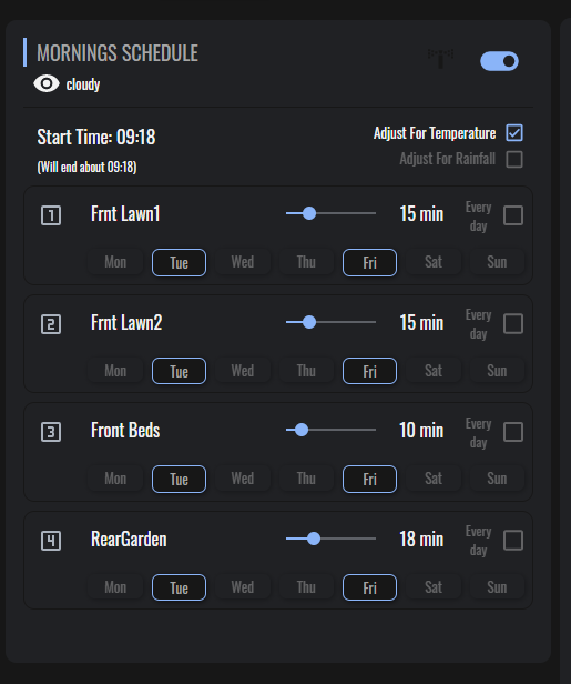

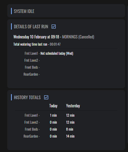

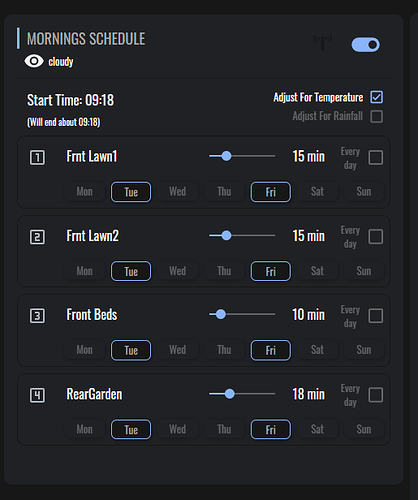

Yeah, there’s definitely something weird going on here.
So, along with the start time and finish time always being the same, it also seems to water on the wrong days.
I have mine set to water on Tuesdays and Fridays, but this morning (Wednesday) it started watering at 09h18.
Only after I clicked cancel did it show the “Not scheduled today” note
Looking like a time/date issue. Maybe 24hour clock vs 12hour?
No idea…But anyway, I can’t use it as it is without running the risk of getting fined by the council for watering on days that don’t apply to me.
Pity, because this is an awesome setup.
