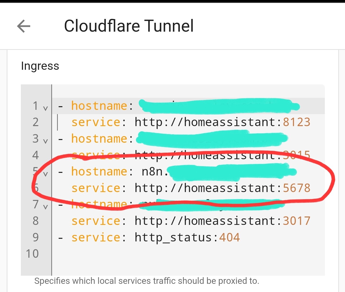

i have a question. So im trying to setup n8n and i got it working locally but i want to be able to access it remotely. i already have a cloud flare tunnel setup for my proxmox and homeasistant working but anytime i try to set the tunnel to go to the http://homeassistant.local:5678 it says bad gateway and won’t work
fixed* i had a dns problem with my proxmox server and was able to get n8n running on the proxmox server so the tunnel was able to work no problem with that setup. I still dont know how to fix it with this addon but i did find a workaround that fixed it. cool addon but sadly didn’t work for me

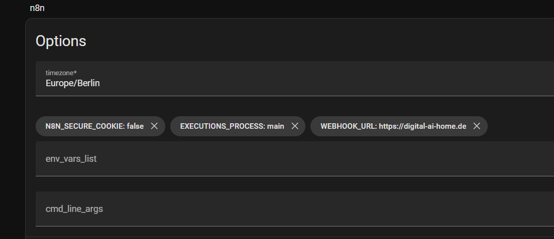

Change WEBHOOK_URL to something like https://n8n.digital-ai-home.de
Make it redirect to n8n web interface.

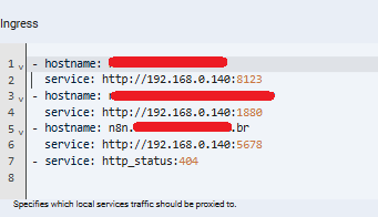

I also use cloudflare, but it didn’t work for me

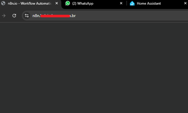

When trying to load the screen goes completely black
Could you tell me what I might be doing wrong?
If you have followed all the instructions, try using the hostname you gave to HA instead of using IP address.
I changed it to the name homeassistant but it stays the same, it loads the page title but everything is black.

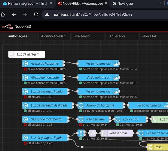

For example, node red, if I try with the name homeassistant:1880, accesses normally.

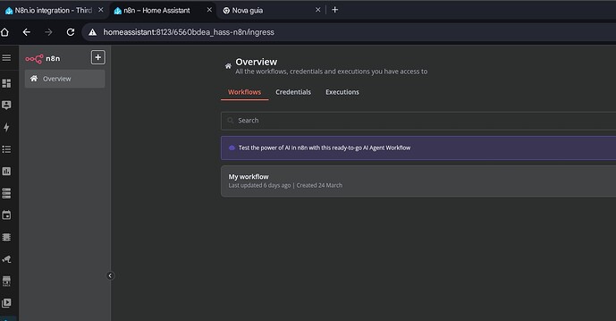

but with the addon it works perfectly

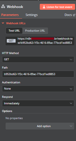

Even though I can’t access n8n through the subdomain, the webhook has changed and is working. In other words, if I access it through the addon, it communicates externally, so it’s already excellent for me. Thank you.
Have you tried different devices/browsers/networks?
By default, cloudflare uses QUIC protocol.
You might consider changing it to http2.
Also, try changing edge ip version to 4.
Both in the addon settings.
All these changes may take some minutes to take effect.
So be patient because some domains may stop working for some minutes and it doesn’t have anything to do with the addon itself.
But of course, the first test is using different devices/browsers/networks to access subdomains externally.

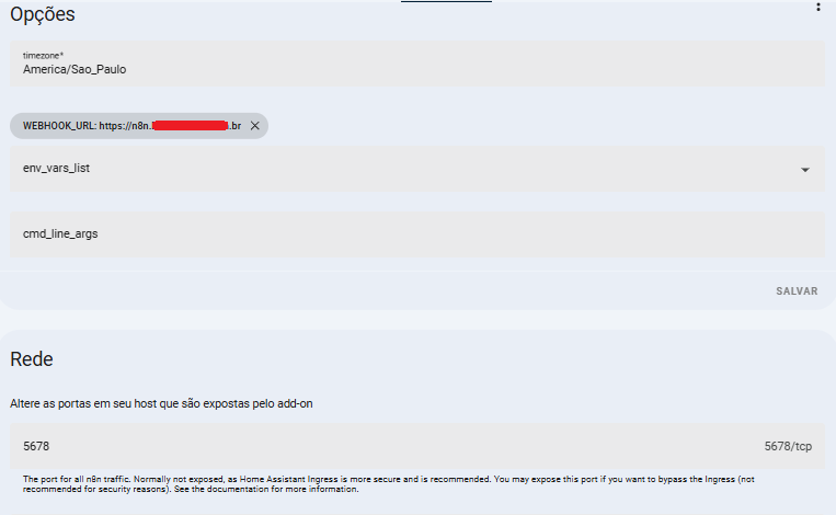

set n8n_path to ‘/’ in env_vars_list.
For example:
timezone: America/Sao_Paulo
env_vars_list:
  - "WEBHOOK_URL: https://webhook.yourdomain.br"
  - "N8N_EDITOR_BASE_URL: https://n8n.yourdomain.br"
  - "N8N_PATH: /"
cmd_line_args: ""
Just put - “N8N PATH: /”
Thank you very much, it works perfectly.
