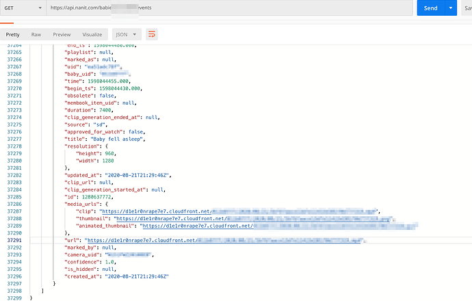

did you grab the correct baby_id from the results?
I got babies[0].id. for GET /babies/1234/events
EDIT: seems like it should be babies[0].uid
EDIT2: Be careful the events endpoint isn’t paginated by default, put a ?limit=100 on it to make sure it doesn’t take forever to return.

are you able to load any of the event video urls?

They load for me:
are you able to play the videos?
I’m not sure how to structure the video with the key (so getting access denied)
At the bottom of the request, the videos are hosted on cloud front and I can play those. I can’t play the ones hosted by AWS.
