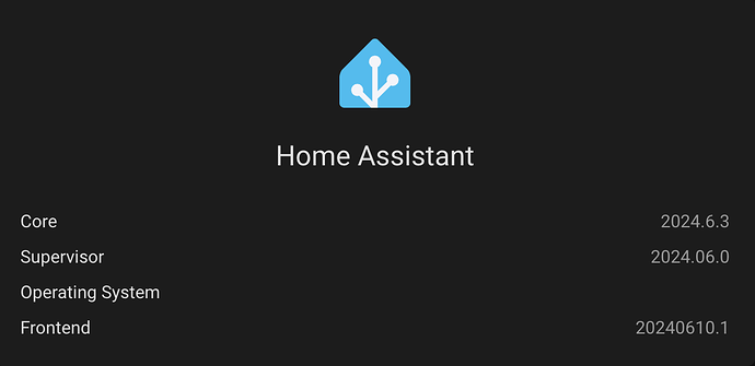

Hello, thanks for continuing to work on this!
I just downloaded the new files on the led-features branch, then deleted and re-added my fireplace. When adding it, its does not list led lights as a feature to select, but it does have a blank selector I would assume is for them.
I added it with that selector turned on, but there are not any controls/entities available related to the led lights on the fireplace.
Combined image of items I mentioned (I am new to the community so can only post one image per post)
Alright, I gave it one more do-over with some testing against an actual device. Please try once more with the latest changes on the branch.
As my fireplace doesn’t have the LED controller I can’t really see if it is working correctly. But at least the Bluetooth controller isn’t throwing any errors and some state related to the LEDs is changing. So theoretically something should happen if you have LEDs installed.
The missing strings in your frontend when selecting the fireplace feature is likely a caching issue. HA caches quite aggressively. I usually have to Ctrl + R a few times before new translation strings show up correctly. I can see them on my test instance.
