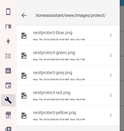

are the images accessible?
/local/images/protect/nestprotect-grey.png
which means that the nestprotect-grey.png etc images need to be store in /config/www/images/protect/

Hi, i must be missing something because the images are not showing up…
Can somebody point me on my mistake :stuck_out_tongue:
What do you see in your debug console in your browser?
You mean this? :thinking:
Indeed. Perhaps you need to restart HA if you didn’t try that? But the path should be correct according to your previous screenshot
i already tryed restarting and know i see that on my mac it works, but in windows not…
