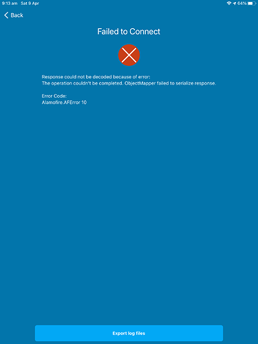

Initially everything was just fine, no probs with Android or IOS Apps, but a month later, when I had to reauthenticate with cloudflare, iPad is unable to connect.
IOS App Log;

Tried uninstalling and reinstalling app from scratch, still same. Android reauthenticated just fine and browser is fine also.
Not sure where to go with this now, having to use browser on ipad, but thats no good as it doesn’t have all the device sensors.

still haven’t got it working again. Android app fine, IOS App fails with ‘ObjectMapper failed to serialise response’ problem after Cloudflare auth.
Mhm this is strange, again for me it is working fine with the iOS app. One thing that comes to my mind might be the standard browser that you have defined in your device.
I am using Safari, and it looks like the app is using whatever standard browser you have under the hood (if I start my HA app, I can see the Safari icon in my MacBook as being used on my iPhone). So maybe other browsers do generate those problems?
Tried again today with email and pin and works, so must have be something wrong with my google auth. Works fine in browser but a little finicky in app.
