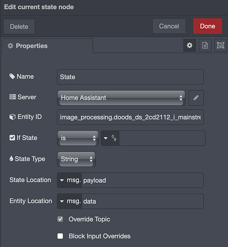

So far I’ve created a sequence and it seems to me the idea works but I’m trying to see if an attribute contains a value (attribute summary contains person) to continue with the sequence:
This is what I got from the debug log:
So far I’ve tried to fetch the attribute person with this line:
msg.data.attributes.summary person
Screenshot 2021-02-01 at 16.34.16
Though it keeps giving me this error:
“Error: Invalid property expression: unexpected ’ ’ at position 23”
Now before I try to debug something I’ve never done before, maybe anyone can point out what kind of node or parameters/properties I am missing or defined wrong?

I’m really starting the get the hang of it, the debug block tells me the information on the second picture from my previous post.
I do not know the appropriate syntax or current state block to see if “person” exists in msg.data.attributes.summary.
According to DOODs and the debug log it should tell me whether “car” or “person” or “truck” exists:
msg.data.attributes.summary.person gives me a wrong example because if person = 0, the attribute does not exist.

I’m kinda missing that kind of code, not sure what to put there (I’ve tried everything in a Current State Node).
All kinds of “is”, “is not”, and I even tried a Switch Node which has an option for “contains” person in the msg.data.attribute.summary however it’s not accepting it. It’s probably due to lack of understanding of code on my side…

So I managed to succeed in building the sequence in Node-RED and it actually works. I feel amazing.
So to help newcomers like me:
  • Basic: define doods configuration according (and credits) to @snowzach
  • First define an events state node:
  • Second create a call service node to scan (using doods):
  • Third, create a current state node to save the complete state of the scan into the data (of the payload):
  • Almost last but not least, create a switch node to check if the key “person” or “car” or whatever label you want exists at the property of msg.data.attribute.summary:
  • Create yourself a notify node or whatever finishes your sequence!
Result of the complete sequence:
