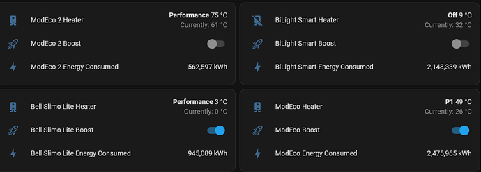

For everyone having the new water heaters with esp32 based PCB(black board, responds with “IoT” on get request to “/”). Feel free to check out my fork of @krasnoukhov extenstion.
I made it work with all waterheaters. All modes and boost are implemented as well as energy monitoring. Automatically identifyes the device model.
Nice work, do you plan to create a PR or are you going to maintain your own fork?
hmm, yes, but euhm, where is the esp32 build to flash if I have to replace the pcb? Or do you mean “after you replaced the old board with a new one from Tesy you can use this”?
Seems i have the newer one:
Works fine, thanks for that.

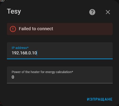

I have Tesy boiler, and i can access it trough web browser, but when I try to add it to HA with the integration, I get “Failed to connect” error. What I am doing wrong, or is there extra steps, before adding it trough the integration?
HA Integration error
For power of the heater I’ve tried leaving it empy, inserting 2 and 2000 (the boiler is 2kW) but still no luck…
Are you sure you have a newer ESP32-based control board? Check out this note in README
I’m not sure about the control board. Just finished reading all the documentation about the boiler I could find, but didn’t found anything about the control board. Any idea how to find which model is in my unit? By the way I am new to Home Assistant, and all smart devices, so I am sorry if I asking silly questions.
