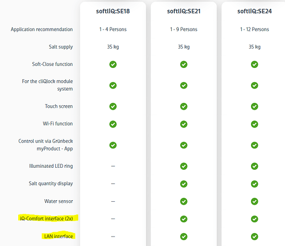

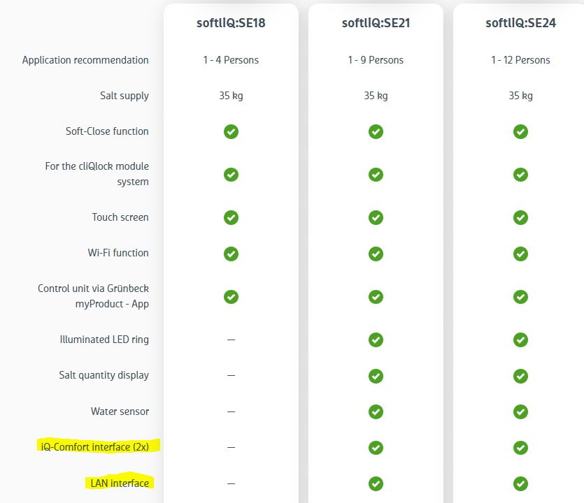

Does the SE18 work with this imtegration as well or just from SE21 upwards?
The SE18 has Wifi as well (and the APP), but I am wondering what’s needed beyond that. From the SE21 upwards there are additional features:
The LAN interface does not help anything. It is only used to connect to the Internet. As all the smart functions require connection to Grünbeck servers, I can’t recommend buying Grünbeck products.
The decision for Gruenbeck has beed made already - but thank you for your feedback. :slight_smile:
I want to connect HA to the Gruenbeck device and wonder if this works already with the SE18 or if it requires a higher version than the SE18.
You can not connect HA to the Grünbeck device. The Grünbeck integration connects to the Grünbeck server which provide the possibility to get the data of your device and to change settings. It is not local. You can connect your HA with any Grünbeck device which is connected to the Internet and the Grünbeck server if you have the login data.
This is what I meant, just a bad idea to use products of a company which do not provide local access. But you can access it, it makes no difference if it connects using LAN or Wi-Fi.
Thank you for the clarification.
