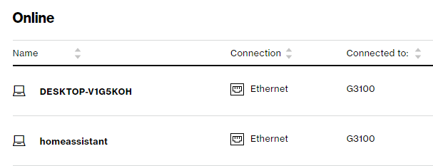

My home network is very basic right now… The windows machine with Virtual Box/Home Assistant is connected directly to a Verizon router. Verizon router does see “homeassistant” and the IP/mac addresses do match up. Those addresses are different from the Windows machine-which I assume is okay in this situation?

So when you return, login into your router. Find the host and HA device. Expand it to see all settings. Screen cap and paste into your response. Thanks
As requested:
homeassistant:
Windows machine:
