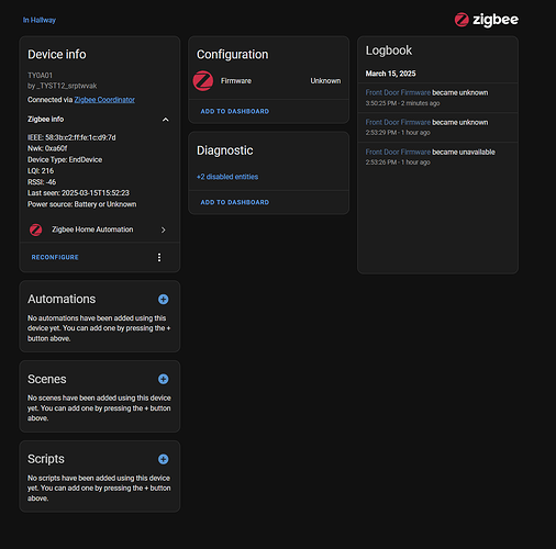

so i spent 2 hours on this so far
i can get it to connect. as unsupproted and supported by updating external converters etc
but no luck. i cannot get it to talk.
here’s what i have so far ( lots of additiona logging) ty0a01.js:

Did anyone manage to get this to work?
I just received mine today, and was quite frustrated to see it doesn’t work with ZHA nor Z2M.
