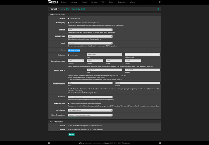

pfsense firewall NAT routing:
Nothing special here. Just port forwarding network ports so my phone or other device from outside the home network can connect with Home Assistant.
