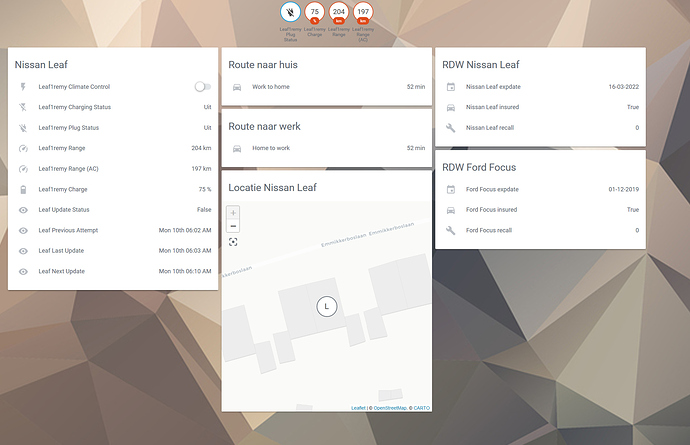

Like this?
You don’t have to add a device tracker, it’s included in the nissan leaf platform. Just use the add entity button in lovelace to add a card (type map).
@remyderuysscher
Yes, that is what I want :slight_smile: !
But… the Nissan location does not show up in the entity list I can choose from if I choose a map…
Looking at your screendump, I also do not have the ‘Leaf Update Status’, ‘Leaf Previous Attemtp’ and the other two below in your ‘Nissan Leaf’ card… Do you have an updated version of the nissan_leaf component?
Is there a way to fire an actual getLocation-request? So the location is not requested every time, but only on demand? My feeling is that requesting the location from the leaf is even heavier then requesting the batt status…

If you have a recent Leaf (40kWh for example) then nissan_connect must be set to true.
The Leaf Update Status is a custom template, not from the component. Debug info looks ok to me.
You can only request a full update (with location info) not a partial.

Here is part of my sensor config file, just put the relevant information in the sensor (XXXXXX) and that should do it.
  - platform: template
