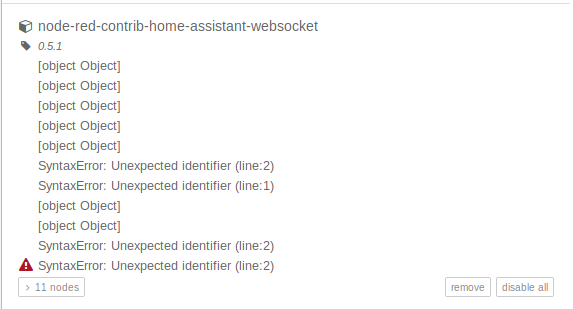

After a crash of my home assistant, Iā€™m moving a lot of my applications into Docker. I have node-red operating in a Docker, but Iā€™m having an issue with installing the home-assistant-websocket node. I donā€™t have issues with other nodes, so Iā€™m assuming that itā€™s maybe a port forwarding issue, or similar inside of Docker. You may, or may not, be able to help and I thought Iā€™d just throw it out and see.
So, the installation goes just fine and completes without any errors. However, as soon as I restart the Docker I receive errors that the nodes canā€™t be deployed. When checking the status I see the blow:
Screenshot%20from%202018-12-31%2008-46-37
Also, pulling up the node-red log gives me this:

31 Dec 16:45:18 - [warn] [node-red-contrib-home-assistant-websocket/server] SyntaxError: Unexpected identifier
31 Dec 16:45:18 - [warn] [node-red-contrib-home-assistant-websocket/server-events] SyntaxError: Unexpected identifier
31 Dec 16:45:18 - [warn] [node-red-contrib-home-assistant-websocket/server-state-changed] SyntaxError: Unexpected identifier
31 Dec 16:45:18 - [warn] [node-red-contrib-home-assistant-websocket/trigger-state] SyntaxError: Unexpected identifier
31 Dec 16:45:18 - [warn] [node-red-contrib-home-assistant-websocket/poll-state] SyntaxError: Unexpected identifier
31 Dec 16:45:18 - [warn] [node-red-contrib-home-assistant-websocket/api-call-service] SyntaxError: Unexpected identifier (line:2)
31 Dec 16:45:18 - [warn] [node-red-contrib-home-assistant-websocket/ha-fire-event] SyntaxError: Unexpected identifier (line:1)
31 Dec 16:45:18 - [warn] [node-red-contrib-home-assistant-websocket/api-current-state] SyntaxError: Unexpected identifier
31 Dec 16:45:18 - [warn] [node-red-contrib-home-assistant-websocket/ha-get-entities] SyntaxError: Unexpected identifier
31 Dec 16:45:18 - [warn] [node-red-contrib-home-assistant-websocket/api-get-history] SyntaxError: Unexpected identifier (line:2)
31 Dec 16:45:18 - [warn] [node-red-contrib-home-assistant-websocket/api-render-template] SyntaxError: Unexpected identifier (line:2)
31 Dec 16:45:18 - [warn] ------------------------------------------------------
Any idea on what might be causing this? As mentioned earlier, I donā€™t have any issues with the installation of other simpler nodes such as timers, etc.
Thanks in advance!
From the README
If you're running Node-Red in Docker you'll need to pull the -v8 image for this to work.
Okay, Iā€™ll give that a shot. Itā€™s running on a Pi so I went with the RPI variant. Iā€™ll see if the v8 plays well with that hardware.
Thanks for the help. Iā€™ll report back once I have a chance to try it out.
thereā€™s a raspberry pi v8 version
rpi-v8
