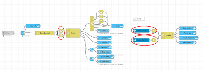

Create a light device like this:
Fill “Echo Device?” node, fill the subsequent nodes with your entities, fill the last four nodes with your fan services and put your input_boolean in the beggining. Don’t touch the entity_id template from the last four nodes.
Fill the error nodes with your preferred sentences. I put some examples so you know what to put there.
When you say just “Turn on fan”, it turns it on at low by default. Change it if you like.
You can use the sentences. “Set the fan to level high”, “Set fan to medium”, “turn on fan to low”, “Turn fan to 1”, “set the fan to 2”, “Turn fan to level 3”, “Turn fan on to level 2”, “turn the fan on to 1”, “Put fan at 3” etc etc etc… 1 low, 2 medium, 3 high. Go try them… it should allow saying set/put/turn to minimun, maximum, middle, low, medium, high, 1, 2, 3, spelling level or not… and even more very likely. Pretty flexible I believe, let me know please, I can’t test it out in english.
You can also increase/decrease the fan speed with a voice command saying somehting like “Alexa, increase the fan speed” or “turn up the fan speed”, not sure to be honest… I know how to request that in Spanish, you’ll have to try it out yourself, but it has to work… If you say ‘increase the fan’ and it’s currently running at level 2, it’ll go level 3.
If you want to control your fans from a different trigger besides the voice…
If you want to control your fans, for example, with some switch (like the philips hue dimmer switch) and via Lovelace, or even if you just want to show the correct status of the fan in lovelace, you should better go this route, it’s more polished. If you want to do that you should create a different input_number for every fan. This way you’ll have a beautiful input_number for every fan in lovelace with which you will also be able to control every fan independently and will update their status if you change your fan status from some other trigger. The rest is pretty much the same than the previous example.
For this particular example, it would be input_number.fan_a_speed and input_number.fan_b_speed. Fill the circled nodes with your entities… fan.fan_a = your HA fan entity for the fan in that area, input_number.fan_a_speed = the input number you have created for that particular fan, and so on
