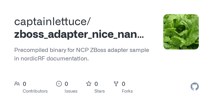

Hi!
My friend helped me compile the ZBoss NCP sample for the Nice!Nano v2 (nRF52840).
Thought i’d mention it here since nice!nano clones can be found very cheap on alix (2 for ~$6).
