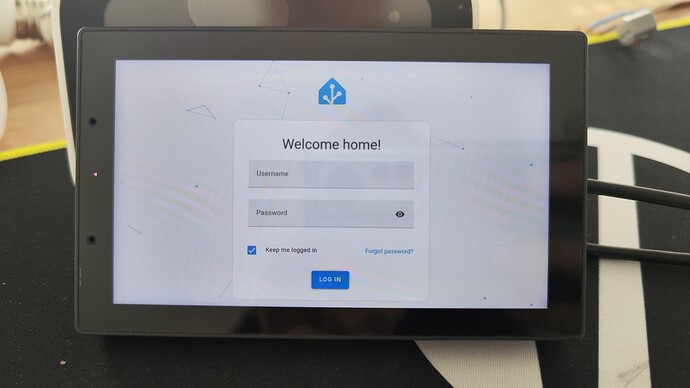

I just had the new NSPanel pro 120 in my mailbox this morning: NSPanel Pro 120 - SONOFF Official
slightly different PCB, USB-Port still accessible when opening the display. Gonna report my findings tonight :slight_smile:
OK, this was stupidly easy :slight_smile:
Turns out you need to do the same procedure as described by Filya75 here: NSPanel Pro - Custom android apps (working) - #52 by Filya75
Steps I took:
#1 Open the display:
a) First remove the metal back
b) Then unscrew the four screws and use some guitar pleks or other mobile phone opening tools to remove the plastic back, so you’ll see the PCB as in my previous post.
c) Now Unscrew the six screws you see there (Note: There is a sixth screw under the fabric tape in the bottom right!)
#2 Install apps:
ADB is disabled, as expected, so we do what Filya75 described in his post:
a) Download the minimal launcher (or any launcher you wanna use) and save it somewhere. Prepare an adb install command for that launcher, like adb install ultra-small-launcher.apk
b) Connect a Micro-USB-Cable with data wires to the USB-Port (no need to loosen the ribbon cables, it’s fine with the screws unscrewed)
c) Smash the adb devices -l command until the display shows up as something like H082012302031503216 device product:px30_evb model:px30_evb device:px30_evb transport_id:8
d) Now execute your prepared install command which should install the launcher.
e) Reboot the device and it should prompt you which launcher you wanna use. Make sure to select the minimal launcher and say “Always” (or not, up to you).
f) Now go to Settings, System, About tablet and hit the build number seven (or eight?) times to enable Developer Mode.
g) Go back and then to “Developer settings” and check that "USB debugging is enabled.
h) You’ll now constantly have adb access and can sideload apps.
Great thing is, the device already comes with an updated Web View component (107.0.5304.105), so no need to update it. I literally just went ahead and installed Fully Kiosk and that’s it. I also recommend installing the latest NSPanel Tools (GitHub - seaky/nspanel_pro_tools_apk) to make use of the proximity and configure other things :slight_smile:
Have fun!
