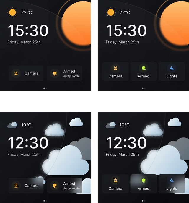

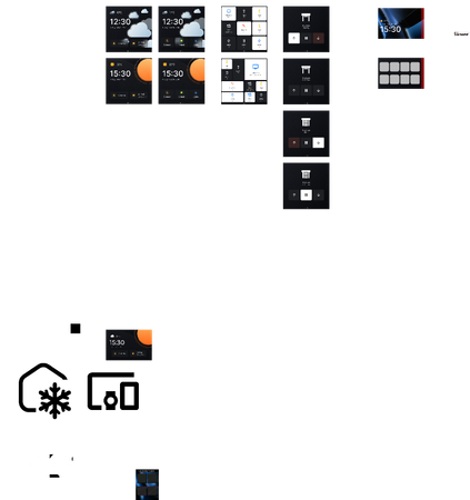

I made a design myself but unfortunately I don’t know how to recreate it in a homeassistant dashboard unfortunately. Feel free to look around in the figma design file it is not quite finished yet.
https://www.figma.com/design/NTGfu0OSVgbh9kz9r4f4Kd/NSPannel
:heart_eyes:
Glad you like it. I am now in the process of converting it to my home assistant dashboard. Do you have any idea how I can create a dynamic background image or maybe with a image element card?

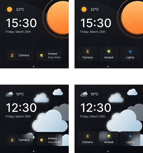

I came back to this and working with a fork of NSPanel_HA_Blueprint. Making it work flauwless with my figma desing!
