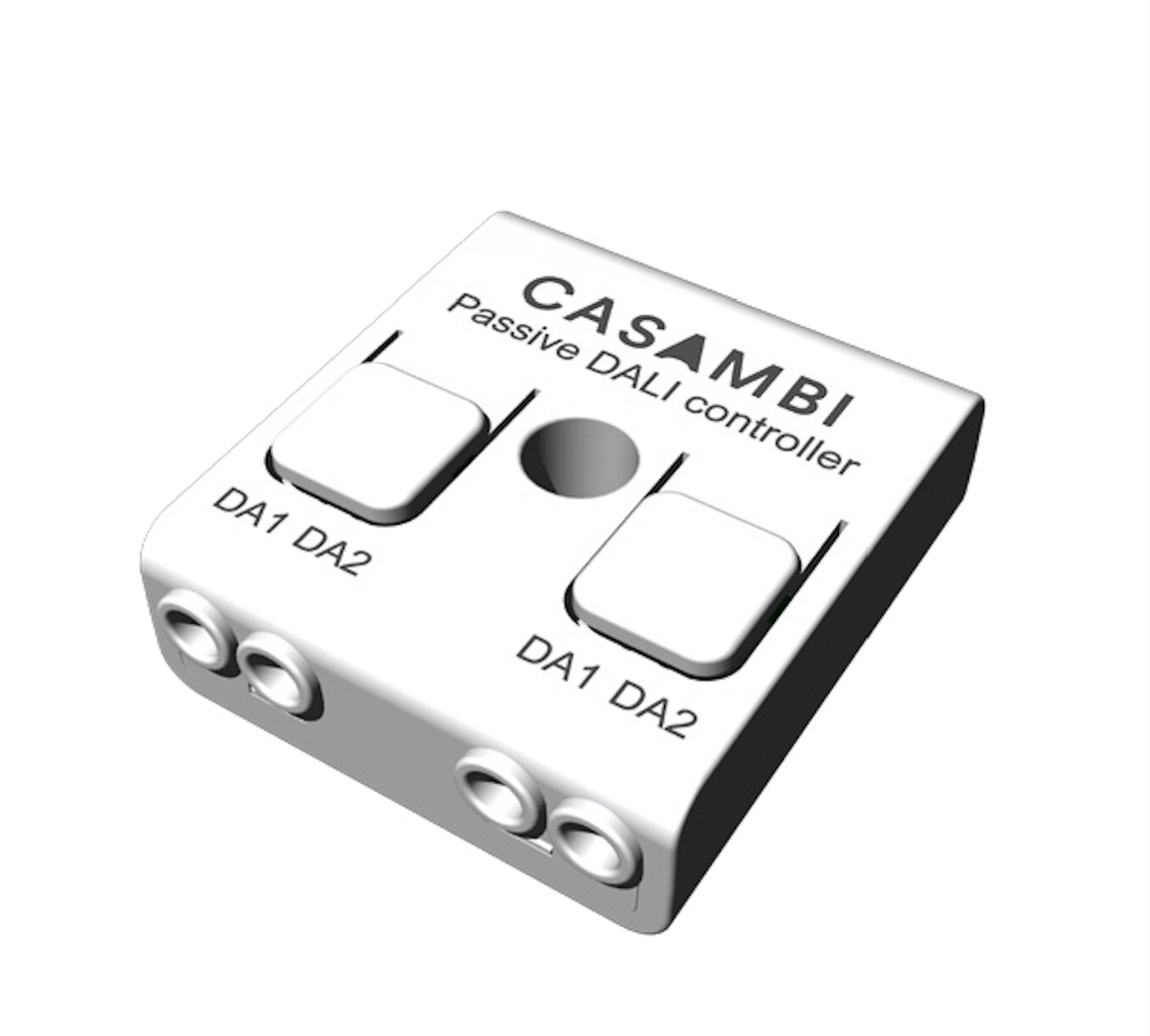

  1. In the Casambi / Tridonic App you need to set the functionality of the Casambi CBU-DCS to “DALI Gateway”.
  2. In the same App you need to turn on the options “Export Light Control”, and “Export CCT Changes” and set the priority to “Manual Control”. See Screenshot1.
  3. Once that is done, press “Scan DALI Devices” in the App, to assign DALI addresses to your Casambi lights. See Screenshot2.
  4. These assigned DALI addresses you can then add to Atios SmartCore in the Webinterface in the “Accessory Manager”. All changes made to Atios SmartCore in the web-interface need to be saved, and the device then rebooted, before they take affect in HA.
Many thanks for the hints! It took me some time to find my way in the Tridonic app but finally understood how to change the functionality of the Casambi CBU-DCS to “DALI Gateway”. I first had to remove it from my network so that the change was possible, then changed its mode and added it again.
Then I found multiple ways of triggering “some” Scan DALI Devices. But had a hard time getting the actual list of assigned addresses below, as on your screenshot, I guess I got it finally using one of the options of the context menu when pressing DALI Configuration (on your screenshot).
Then I configured all accessories, rebooted, did the pairing and everything again in HA, just to be sure, and ended up seeing my 5 devices in HA, which I then manually identified to give them some meaningful name.

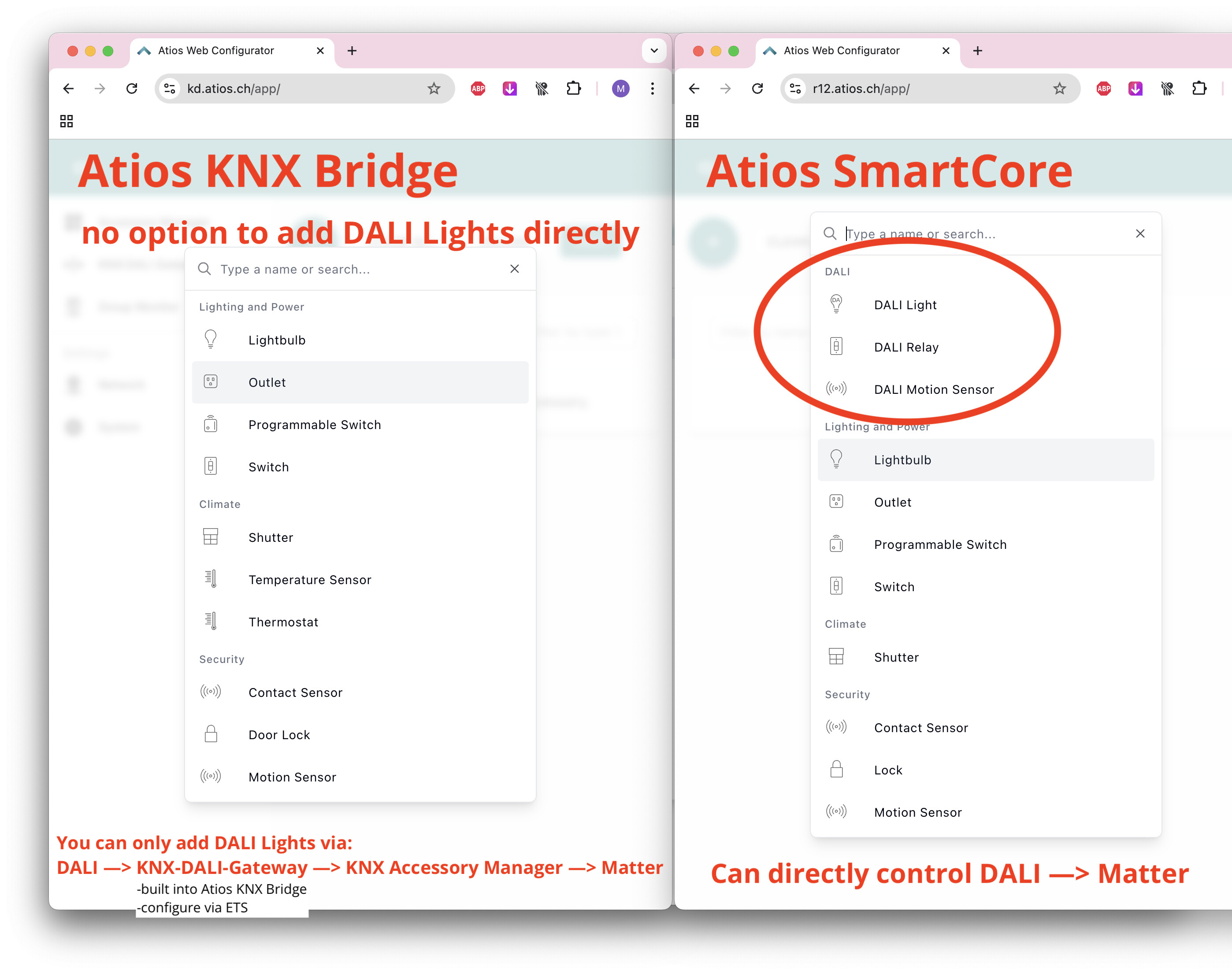

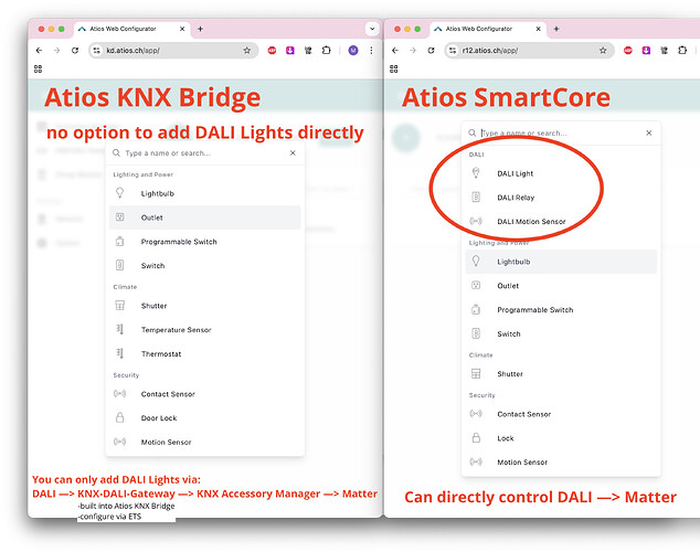

Just to update everyone. This option is not possible anymore. Since Atios KNX Bridge is intended for KNX Systems, and we have released a firmware with a built-in KNX-DALI Gateway, we were forced for synchronization and to streamline firmware support to issues to remove the direct DALI → Matter possibility.
If you want to control Casambi via Matter, you currently need an Atios SmartCore + CBU-DCS unit.
We are thinking about releasing long-term a native Matter Casambi Gateway… will keep you updated. But this is approximately 6 months out.
