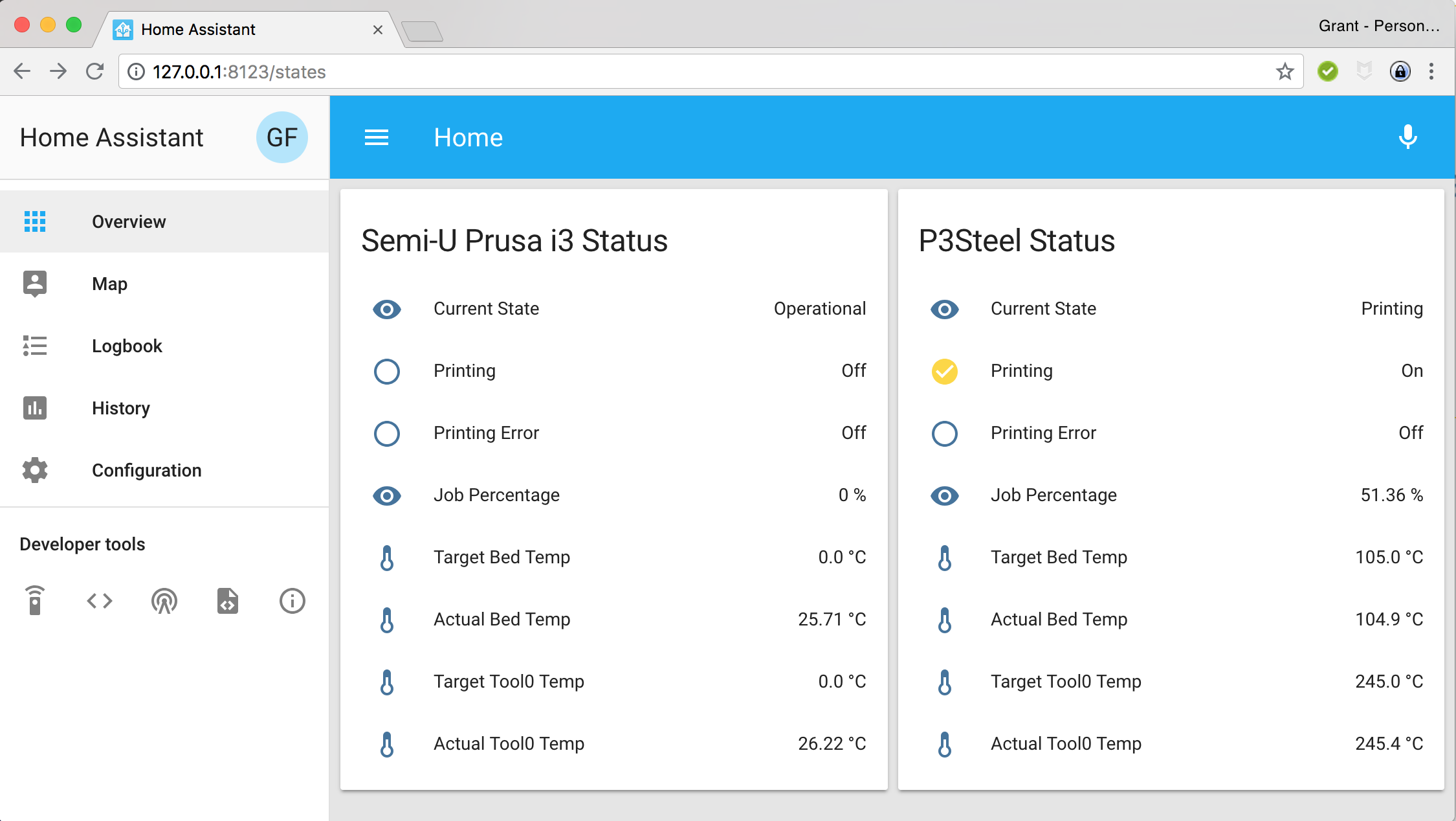

Here is a picture of my docker run with a configuration that works with my two working Octoprint servers:-

Works a treat as a custom component on 76.2. Thanks to all these involved.
