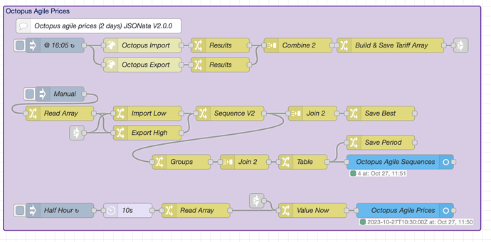

I got it working, well I have cleared the errors. I had to ticket the Enable global context store. That was the only difference from my setup to your screenshot. Mine now looks like this.
Do I have to wait until 4.05pm to test. I can’t see how to trigger it manually.
Thanks again for the help.
The ‘enable global context store’ is optional. That just sets the websocket nodes to copy the entire HA state to a global context variable, which is useful if you know it is there.
The flow starts with an inject node. This can be set to trigger at NR start, and at regular intervals. I have set this to repeatedly trigger at 16:05 every day (just because I thought this a good time). However there is absolutely nothing stopping you from clicking the usual ‘button’ on the left and manually triggering the flow. The only time the manual button will not work is when you have made changes to a flow, and an ‘redeploy’ is required.
Enjoy.
I just removed the whole flow again for my own peace of mind. All I had to do was click on the blue icon, then the entity config, press update, done and deploy and it all worked. As you say, no need to tick the optional box.
My only issue now is, I have no prices. I have the sequence table.
This behaviour has been seen before by others but I have not yet worked out why.
You must have the tariff prices generated otherwise the sequence table would not appear. Check in the flow context for OctAgileTariff - array of 96 objects.
Your Octopus Agile Prices sensor has also fired - see the status for 10:30 (11:30 BST) at 11:50, so I assume all is OK there.
I think that HA does not like the size of the attributes (I am passing the entire array here which is quite large) and so it does not load them / show them in the developer > states list.
Others have reported that it all appears eventually, so check the flow context first.
I have made several changes to the flow to include DST and local time, however this just increases the size of the array and upsets HA even more, so I need to look at how to manage this better.
I do have 96 entries. I will leave it an see what happens.

PedroKTFC fixed this previously by recreating the config nodes.
Alternatively, it may be down to my erroneous use of ‘State Class’ of measurement, which is no longer tolerated for strings. I suggest editing the Octopus Agile Sequences node, to be able to edit the sensor config node. In the config node, set the ‘state class’ to blank (top option) and try that.
That has fixed it. I assume you meant this part.
I changed Octopus Agile Sequences (I might not have press deploy in my haste), first that made no difference, I then changed Octopus Agile Prices and that worked. They are now both blank and I did press deploy.

I have been fixing a couple of issues in this flow, adding DST time management, and a binary on/off best price sensor. The DST stuff is painfully difficult to test as clock change only happens twice a year, so I am planning on getting up at 01:45 tomorrow morning as I want to watch to see exactly when my Home Assistant Blue changes the internal time. Octopus Agile rates are all done as UTC, but there are potential issues if HA changes at an odd time in the middle of the night and my inverter is still waiting to be manually updated.
My current issue is that my flows are now too big to post here. Also, I have issues with the size of the array being moved in the attributes, and I would like to see if there is a way of distributing arrays over two or more sensors, then recombining in HA. I certainly need to try setting up with Node-RED projects and connecting to GitHub / Node-RED forum to see if I can improve the ‘release’ side of things, so don’t hold your breath!
