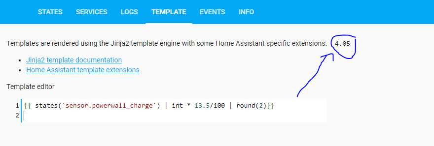

Now im at the stage where I want to convert the percentage left in the powerwalls to KWh, and then use the last X hours usage to give an estimated time that the powerwall will run out (either in X time remaining, or an estimated time of day it will run out)

The kWh calculation is quite easy using a template, I calculate this now but don’t use it yet, however, keep in mind the % from tesla is not linear so this is a “best guess” at what the % converts into. Also if you have any backup reserve etc etc.
