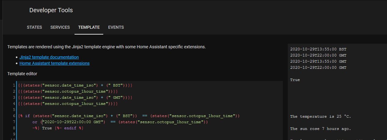

Did you manage to get this working? I’m having the same issue, where everything looks great, blocks are set up and updating, but the automation never triggers…
Sorry, forgot to post an update, I used the following in the end in a sensor
sensor:
- platform: template
sensors:
best1hourslot:
friendly_name: Best 1Hour Slot
value_template: >
{% if states("sensor.date_time_iso") == (states("sensor.octopus_1hour_time")[:-4]) %}
true
{% else %}
false
{% endif %}
A trigger in your automation would work the same iguess, not tested as I like having a sensor I can flip
I have not tested but you can also try the following as updated by @badguy on his OctoBlock github
trigger:
value_template: '{% if (states("sensor.date_time_iso") + (" BST")) == (states("sensor.octopus_1hour_time"))
or (states("sensor.date_time_iso") + (" GMT")) == (states("sensor.octopus_1hour_time"))
-%} True {%- endif %}'
Thank you! I had tried the updated template from the octoblock github, but that doesn’t seem to be working for me either. I’ll give this a go
Check you have all the time_date options set in your sensor section
- platform: time_date
display_options:
- 'time'
- 'date'
- 'date_time'
- 'date_time_utc'
- 'date_time_iso'
- 'time_date'
- 'time_utc'
I have them all and not run into a date issue
Just double checked, I’ve definitely got time_date set up, exactly as you have it.
