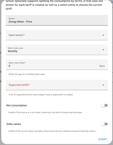

Thanks! Trying to get my head around how to configure this - how do you fill in the config here?
Supported Tariffs comes back as blank. Input sensor I was going to use the IO On/off binary sensor but it’s not selectable.
I would recommend the following:
Set the input sensor to your usage: this your cumulative total (or cumulative daily) meter usage in kWh
Add two tariffs, one called Peak, one called Off Peak (type them into the box and hit enter for each)
Then you can use an automation to switch between them
