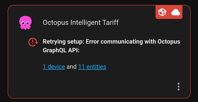

Hum… the integration stopped working for me just now. Here are 2 screenshots taken from the HA mobile app:
Mine went ‘unavailable’ at 20.39 this evening, same error.
I am seeing the times in the Octopus App however, it is being slow but is loading my timeslots…
Same here, Octopus app slow but working.
All working again now.
