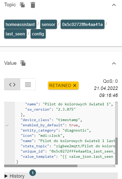

I’ve enabled all my ‘last seen’ sensors earlier, but I’ve added this to my Z2M configuration:
device_options:
  homeassistant:
    last_seen:
      enabled_by_default: true
Restarted Z2M and HA, and checked with MQTT Explorer discovery topics for ‘last_seen’ sensors:
As you can see - enabled_by_default is true, so it works…
Try manually set Home Assistant status topic to offline and online few times (default is hass/status for Z2M)

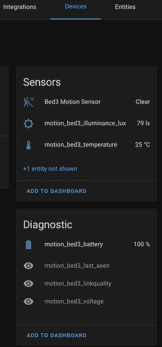

If you are using the latest version of the blueprint, it now looks for a last_seen entity rather than the last_seen attribute within an entity.
These need to be enabled within HA → Configuration → Devices
Select the _last_seen entity within Diagnostic:
Change to enabled and then restart HA:
Hope that makes sense?
Ah I understand now, thank you for explaining :+1:
I’ve enabled that previously disabled entity for the one device that has been offline, and added {{sensors}} to the start of the notification message, and ran the automation - works perfectly :smile:
