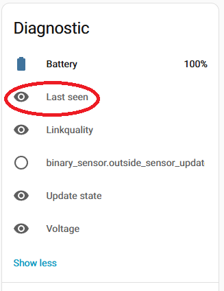

I got the same empty list issue until I enabled Last Seen in Diagnostic for every ZB devices.
Settings → Devices & services, then select the Devices tab, look for your ZB device, select it. If under Diagnostic last seen is gray out like in the image below, you will need to enable it. Click “last seen”, then the gear icon, then enable.
