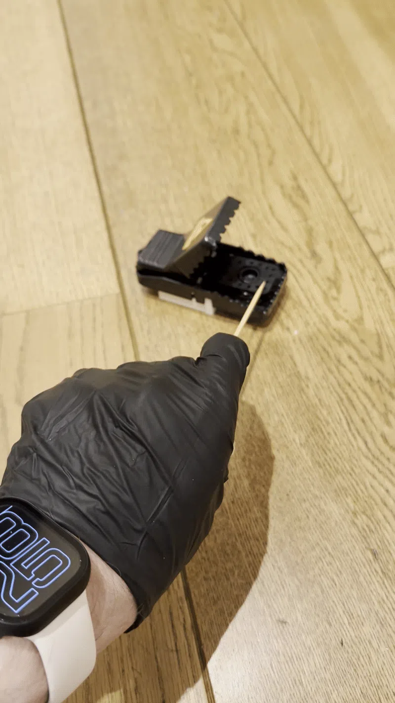

Hey everyone,
I wanted to share my own twist on the whole home automation idea—a 3D printed project called the Smart Mouse Trap Adapter. It’s designed to work with a Zigbee Aqara vibration sensor that’s neatly housed inside a protective box (with one open side) that attaches to your regular mousetrap. When the trap is triggered, it sends notifications through Home Assistant.
One fun addition is that I recommend using “katten snoepjes” (cat treats) as bait—apparently, the rodents really can’t resist them! Also, I integrated a helper input_boolean into the automation. It doesn’t prevent duplicate notifications but instead acts as a reminder in case you missed one.
I’m excited to see how others might build upon or modify this idea. Would love to hear your thoughts and any suggestions you might have. Happy automating (and trapping)!
