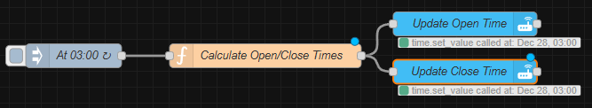

I use node-red for nearly all of my automations, so the way I do it probably won’t suit you so well, but for what it’s worth:
At 3am every morning, get the day’s dawn and sunset times using the SunCalc module with a little script, add an offset to those and use the time:set_time action to set them on the door.
I choose 3am as it’s after the clocks change where I live (UK we jump from 01:00->02:00, and 02:00->01:00). So by the time it runs, the calculations will be for the changed clock. It’s also sufficiently before dawn on the longest day of the year to ensure it runs before it’s needed.
I’m happy to share the script, but I think @Tillsy’s solution is probably more appropriate.
